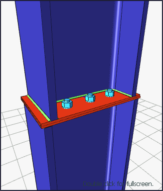

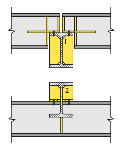

Defining a Column-Column End Plate Splice Connection
With the Column-Column End Plate Splice command, additions are defined in columns.

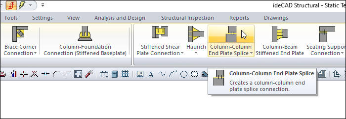

Location of the Column-Column End Plate Splice Command
  • From the Connection menu, click on the Column-Column End Plate Splice icon.

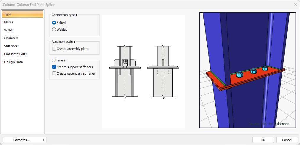

Type Tab
Connection type
Bolted or welded connection types are selected.
Assembly plate
The assembly plate can be added to the joint by checking the option.
Stiffeners
By checking the options, support and secondary plate can be added to the connection.

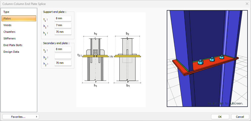

Plates Tab
Support end plate
The support end plate is determined by entering the value. The values ​​to be entered are shown in the schematic drawing.
Secondary end plate
The secondary end plate is determined by entering the value. The values ​​to be entered are shown in the schematic drawing.

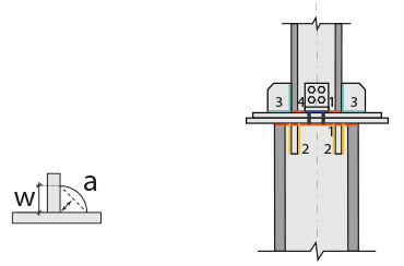

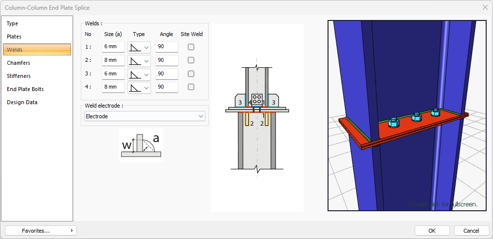

Welds Tab
Welds
Weld electrode

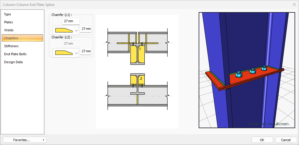

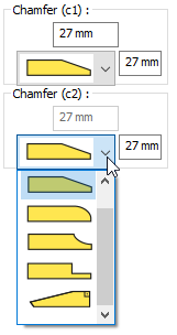

Chamfers Tab
Chamfer (c1, c2)

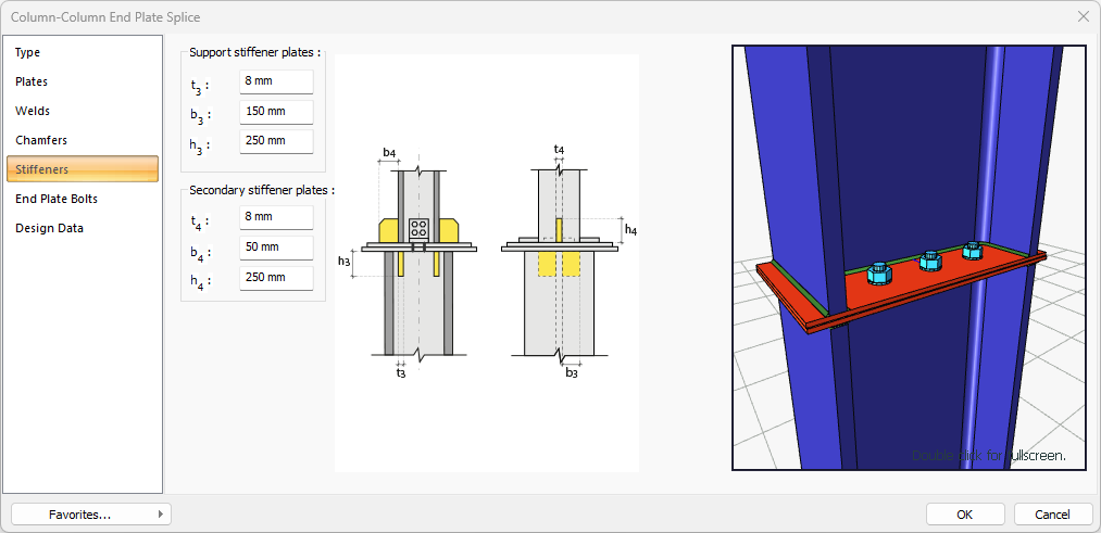

Stiffeners Tab
Support stiffener plates
Support stiffener plates are determined by entering the values. The values ​​to be entered are shown in the schematic drawing.
Secondary stiffener plates
The secondary stiffener plates are determined by entering the value. The values ​​to be entered are shown in the schematic drawing.

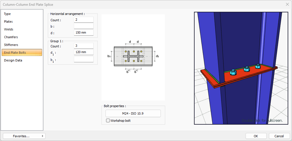

End Plate Bolts Tab
Horizontal arrangement
Group 1
Bolt properties

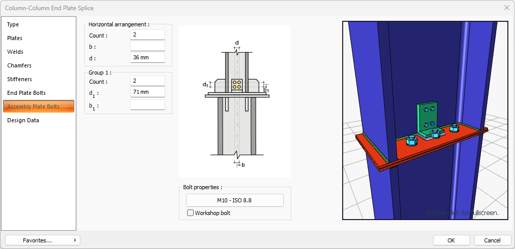

Assembly Plate Bolts Tab
This tab appears when the assembly plate is marked in type tab..
Group 1
Bolt properties

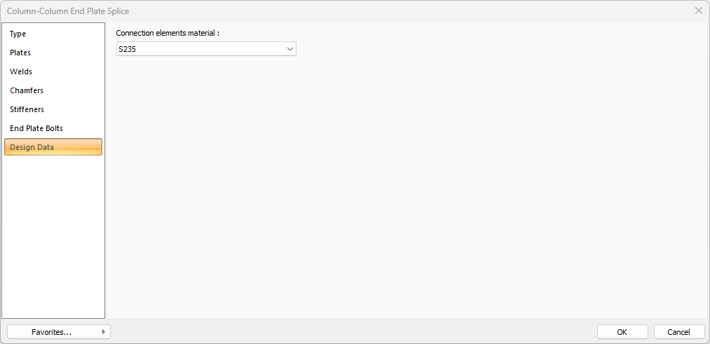

Design Data Tab
