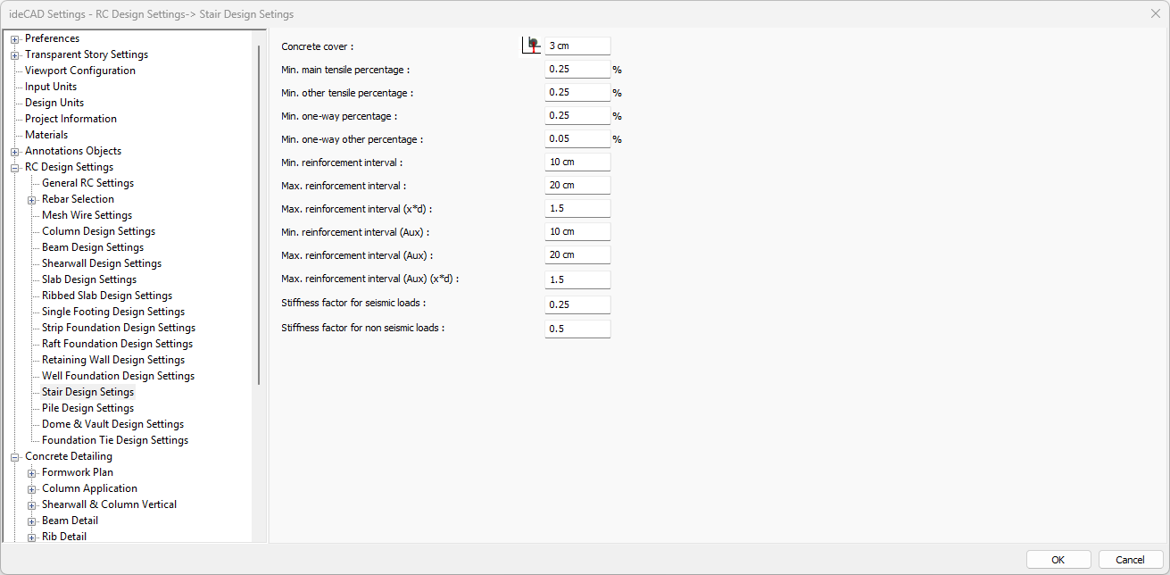

Stair Design Settings Section
With the Stair Design Settings, the design parameters used in the Concrete Stair Design are determined. Concrete cover, maximum and minimum reinforcement interval, minimum tension percentage for main and other direction, etc. parameters are determined from the stair design settings window.
Parameters denoted with “%” refer to the reinforcement ratio expressed as a percentage—that is, the ratio of the area of reinforcing steel to the gross cross‑sectional area of the concrete element, multiplied by 100.
For instance:
  • A minimum reinforcement ratio of 1% corresponds to a steel area equal to 1% of the concrete section.
  • Since a reinforcement ratio of 0.01 (i.e. 0.01 × 100) equals 1%, the value “1” should be entered for this parameter.
All percentage values must be entered as the ratio multiplied by 100. If your design software requires integer percentages, round to the nearest whole number.
Concrete cover
It is the distance from the center of gravity of the rebar to the outer face of the concrete.
Min. main tensile percentage
It is the pull pursuit in the short edge direction of the plate in the plates working in double direction. This parameter should be written as a percentage.
Min. other tensile percentage
It is the pulling pursuit in the direction of the long side of the plate in plates working in double direction. This parameter should be written as a percentage.
Min. one-way percentage
It is the pulling pursuit in the short side direction in the plates with the long side 2 times more than the short side (Llong/Lshort ≥2). This parameter should be written as a percentage.
Min. one-way other percentage
It is the pulling pursuit in the long side direction in the plates with the long side 2 times more than the short side (Llong/Lshort ≥2). This parameter should be written as a percentage.
Min. reinforcement interval
This parameter is taken into account when selecting the rebar. If the distance between two rebars is less than the minimum rebar spacing, the rebar diameter is increased.
Max. reinforcement interval
 The distance between two rebars cannot be more than the value entered in this parameter. The maximum range of rebar is used together with the x * d parameter.
Max. reinforcement interval x * d
 The default value for this parameter is 1.5. The value entered in this parameter is multiplied by the thickness of the plate. The value found is the maximum rebar range and the distance between two rebars cannot be more than the value calculated from this parameter.
Min. reinforcement interval (Aux)
It is the parameter that limits the minimum distance between additional rebars. This parameter is taken into account when selecting additional rebar. If the distance between two additional rebars is less than the minimum rebar spacing, the rebar diameter is increased.
Max. reinforcement interval (Aux)
It is the parameter that limits the distance between additional rebar. The distance between two additional rebaris not chosen more than the value written here. The maximum rebar spacing is compared with the parameter x * d and the smaller one is used.
Max. reinforcement interval (Aux) x * d
It is the parameter that limits the maximum distance between additional rebars. Plate thickness is diametered with the value entered in this parameter. The value found is the maximum rebar range and the distance between the two rebars is not chosen more than the value calculated from this parameter.
Stiffness factor for seismic loads
It is the parameter that determines the stiffness factor for earthquake loading in stairs.
Stiffness factor for non seismic loads
