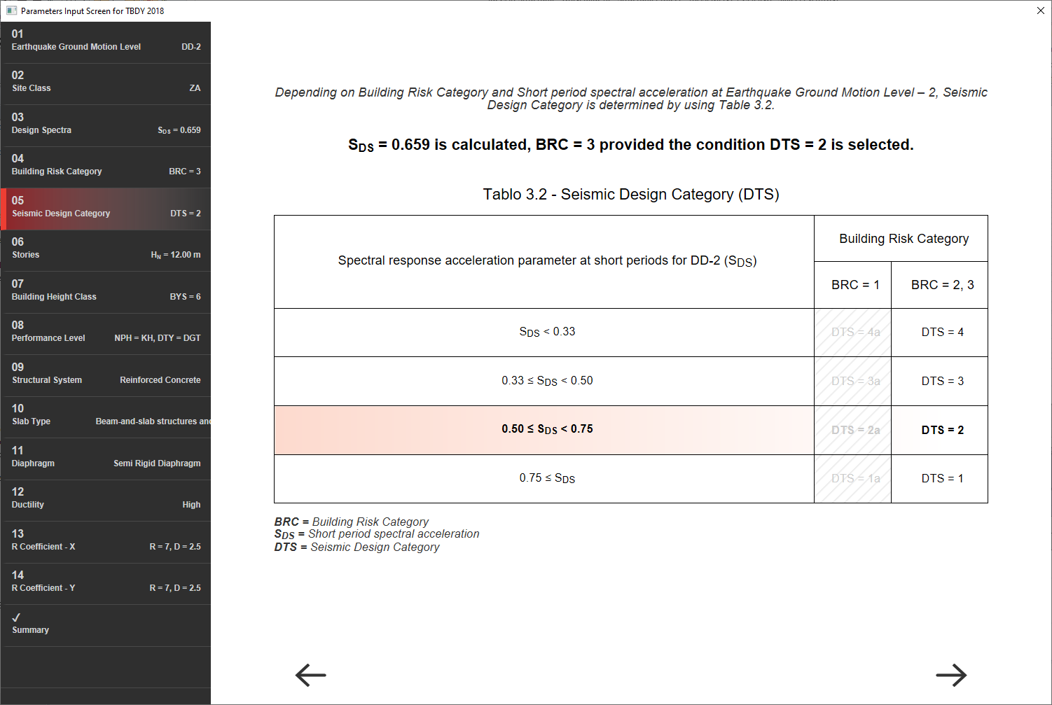

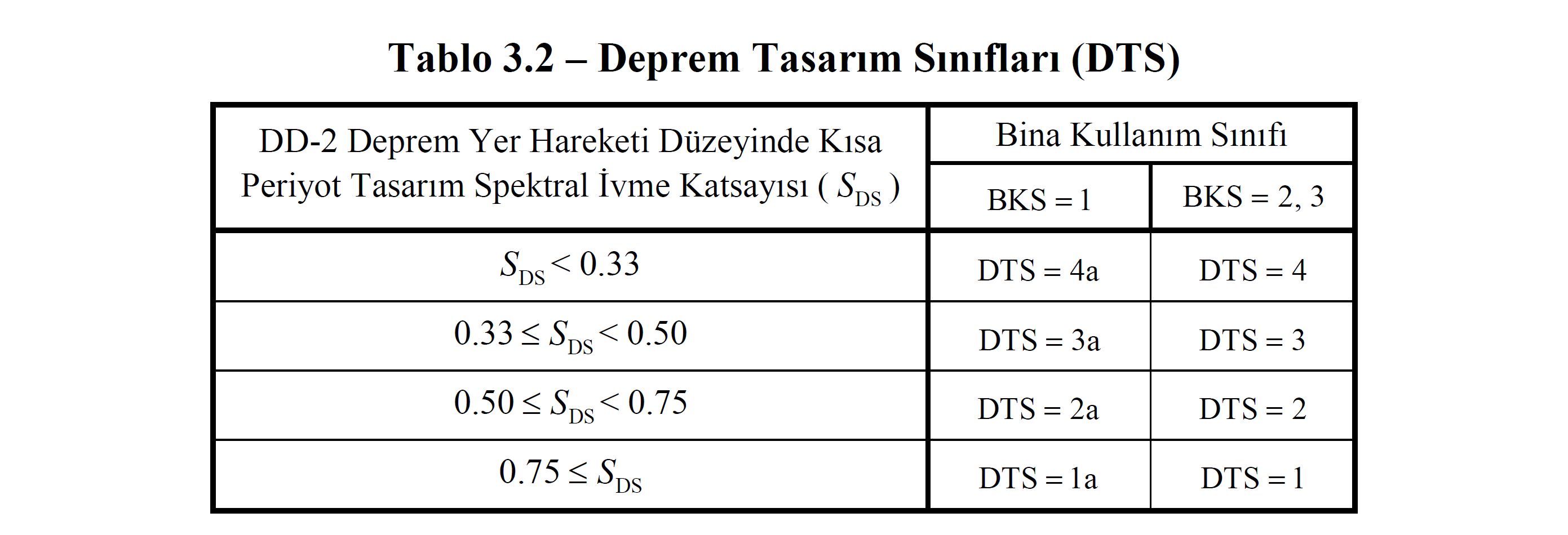

Determination of Seismic Design Category (3.2)
It is determined automatically according to Table 3.2 , depending on the S DS parameters defined in 2.3.2.2 for Building Use Class and DD - 2 .
ICONS
BKS = Building Use Class
DTS = Earthquake Design Class
DD-2 = Earthquake ground motion level with 10% probability of exceedance in 50 years (recurrence period 475 years)
S DS = Short period design spectral acceleration coefficient
While the Design Based on Strength (DGT) approach is applied, the short-period design spectral acceleration coefficient defined in 2.3.2.2 for Building Use Classes (BKS) and DD-2 in accordance with Article 3.2 of the TBDY is determined according to Table 3.2 , based on S DS parameters . Earthquake Design Class (DTS) is determined.
TBDY 2018 Analysis Setup Wizard , Building Use Class (BKS) and S DS by using parameters Earthquake Design Class (DTS) automatically determines.
