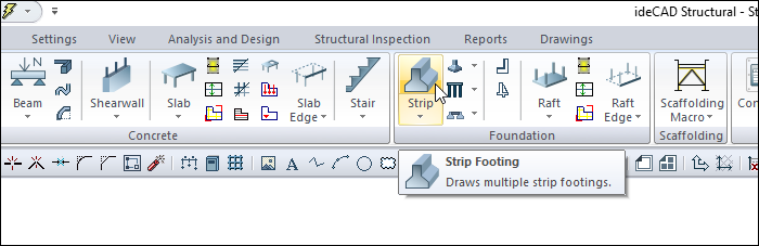

You can access it from the Concrete tab in the ribbon menu, under the title of Foundation.

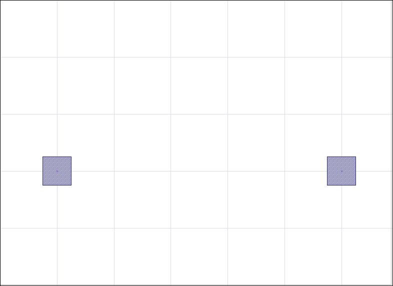

To define a strip footing between the two columns above;
  • Click the Strip icon in the ribbon menu .
  • The strip footing toolbar will be opened.

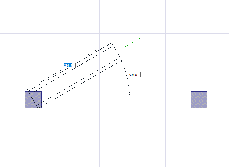

  • You can define your strip footing by holding different points (lower corner, middle or upper corner) by clicking the alignment button on the strip footing toolbar or pressing the spacebar. Every time you press the spacebar, your alignment will change.

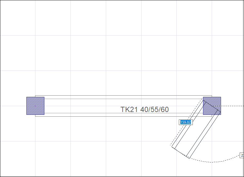

  • Once you've identified the first point of your strip footing, move the cursor over the second column.
  • When the cursor changes shape, click the left button again. The program will create a preview of your next strip footing.

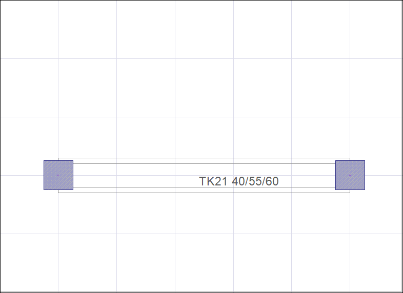

  • Press esc to exit the command. Your strip footing will be formed.

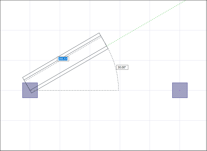

Establishing the first point of the strip footing
Changing the offset by pressing the spacebar

Creating a new strip footing preview by creating the second point

Completing the strip footing
