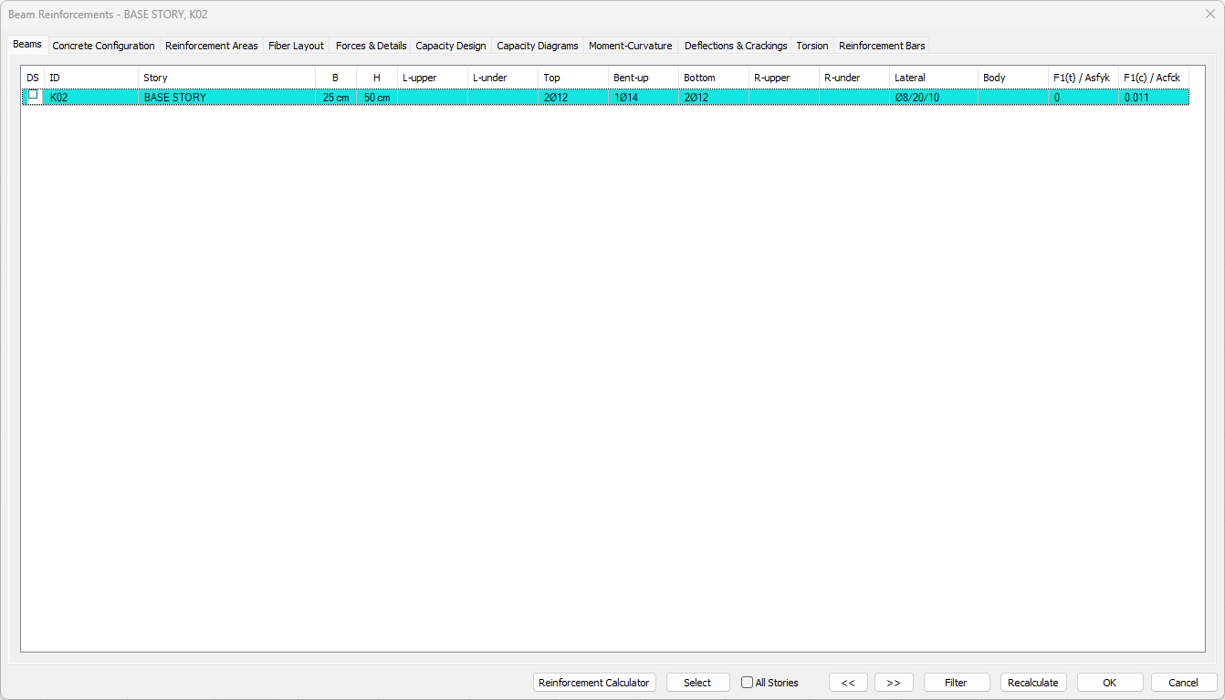

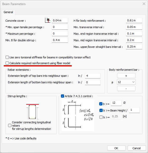

  • From the Beam Parameters window , you can activate the "Calculate the required reinforcement using the fiber model with" option.
  • From the Beam Reinforced Concrete window, reinforcement can be increased or beam dimensions can be enlarged.

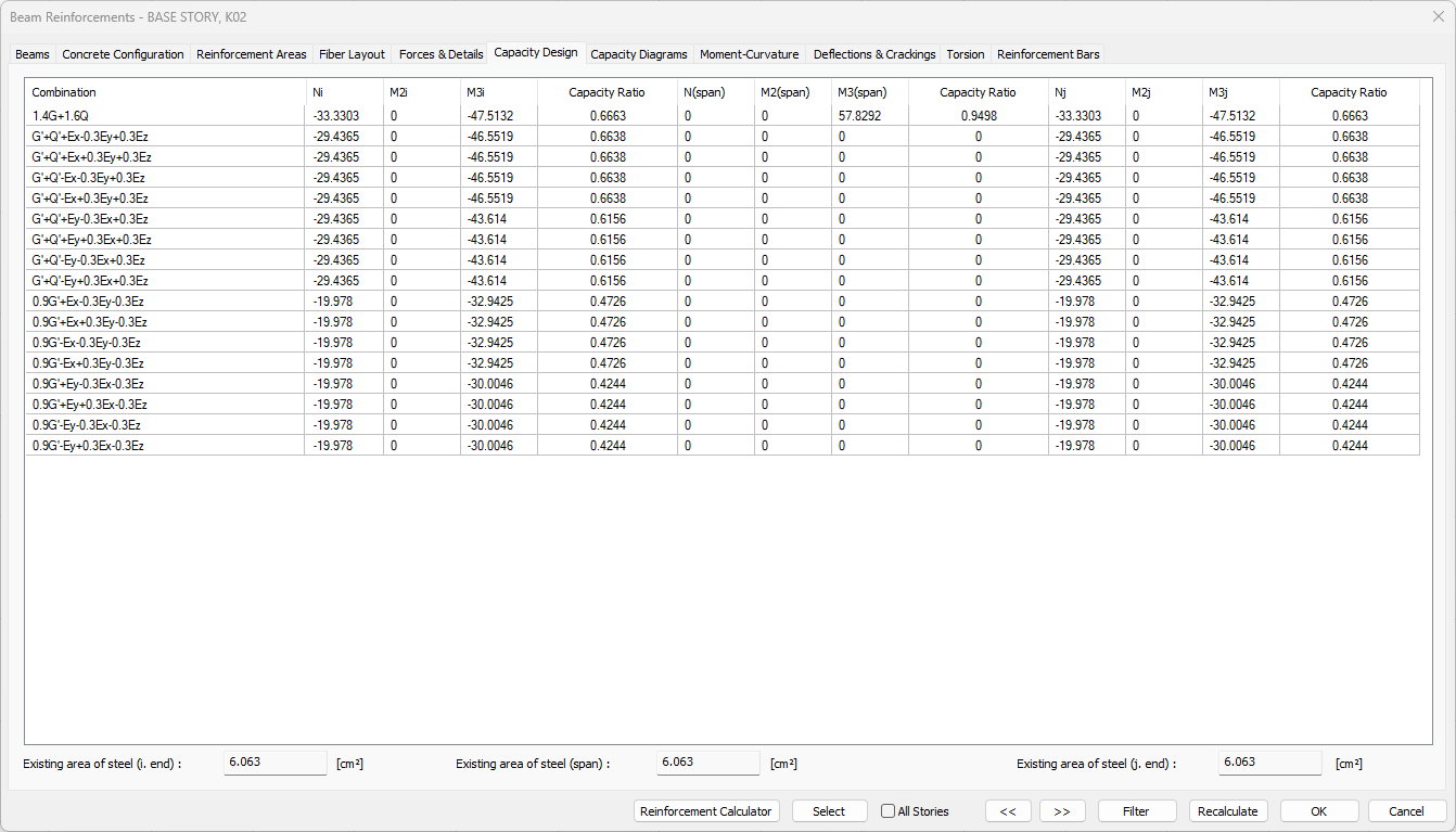

  • Detailed information of the capacity ratios in beams can be seen in the Capacity design tab of the Beam Reinforced Concrete window . Using this section, it can be seen in which section of the beam, under which combination effect, the capacity ratio is exceeded and can be intervened appropriately.
