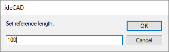

  • Enter the current length value 100 in the dialog that comes up and click the OK button.

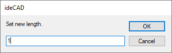

  • The same dialogue will come across you again. Enter the new length value 1 and click the OK button.
  • At the end of the process, you will make your drawing 100 times smaller.
