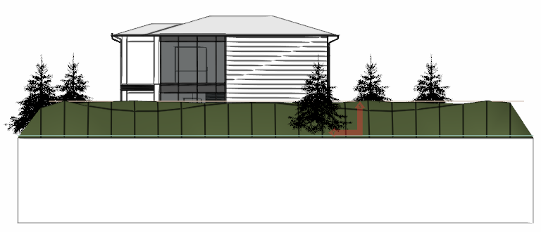

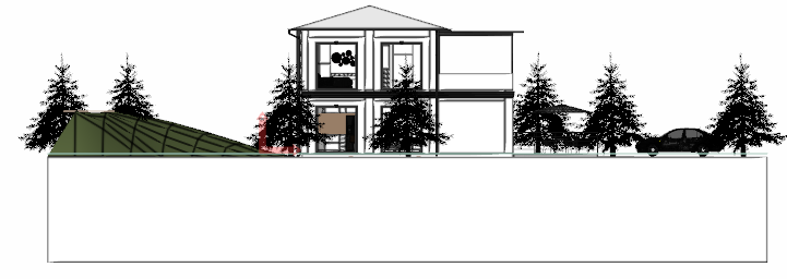

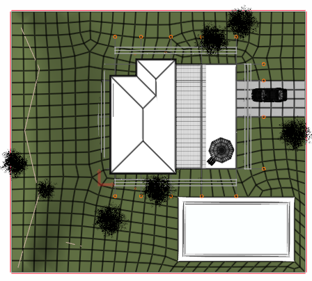

3D elevation views are view of the model from a bird's-eye view from the front, back, left, right and top and bottom.

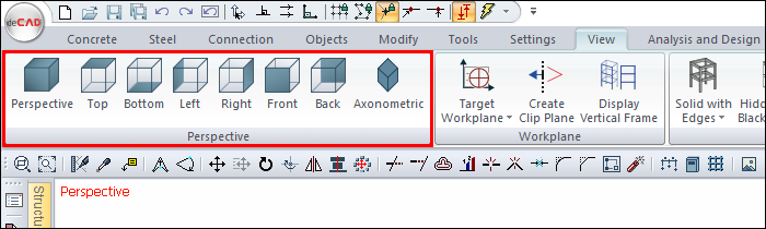

It is located under the heading perspective in the ribbon menu.

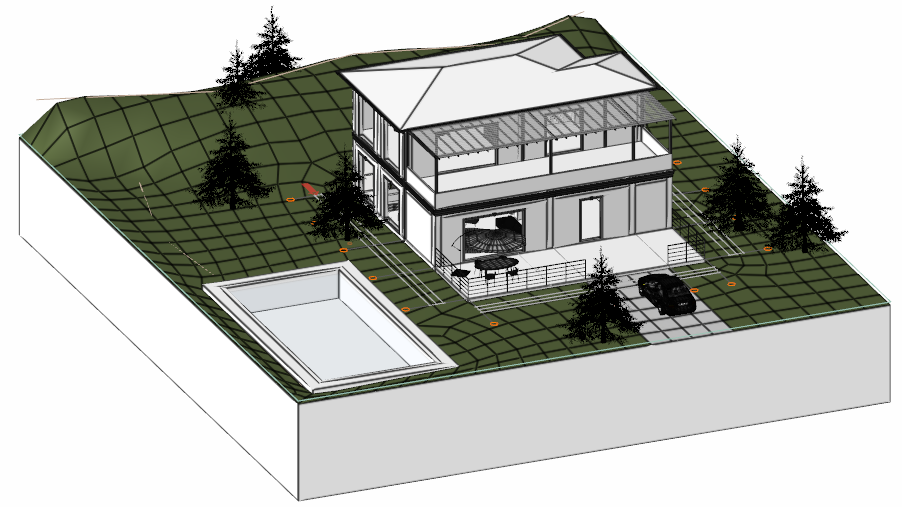

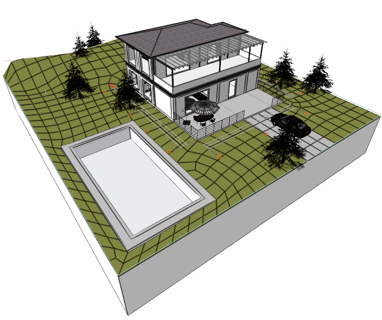

Sample views

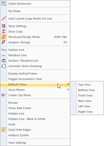

Alternatively, it can be operated on the right button menu in 3D.
  • Click the right mouse button on the viewport.
  • Switch between Axonometric View and Perspective View by clicking on the Toggle Axonometric View line from the menu that open.
  • When you come to the Default View line from the menu that opens here, click on the lines Top View, Bottom View, Front View, Back View, Left View, Right View with the left mouse button.
  • The active view window will switch to the selected view window.
