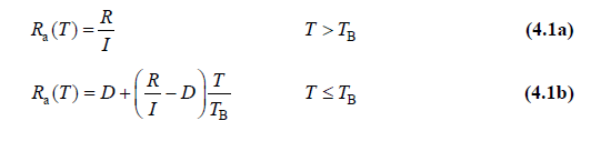

The earthquake load reduction coefficient R a (T) is determined automatically by Equation 4.1a and 4.1b .
  • R and D coefficients in the equations are under user control.
  • R and D coefficients selected by the user in the analysis settings wizard and report results are checked automatically. R and D coefficients that do not comply with TBDY are not allowed.

4.2.1. Earthquake Load Reduction Coefficient
4.2.1.1 - Within the framework of Design Based on Resistance , the definition of the predicted ductility capacity - strength demand relationship and the earthquake load coefficients determined accordingly are given in ANNEX 4A .
4.2.1.2 - According to the definition made in ANNEX 4A , the Earthquake Load Reduction Coefficient to be taken as basis in reducing linear elastic earthquake loads is defined as follows:
