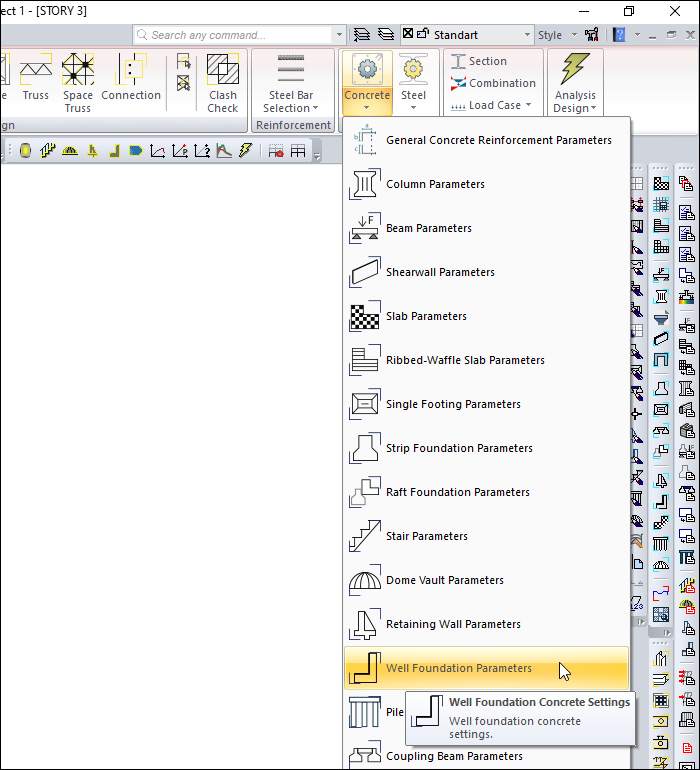

Location of Well Foundation Parameters Dialog
Ribbon menu Analysis and Design tab Design Parameters title under well foundation parameters by clicking on the command Well Foundation Parameters can be found in the dialogue.

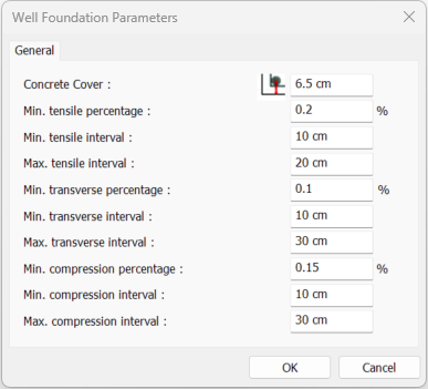

It determines with parameters which criteria the program will comply with in concrete design and rebar placement stage.
Parameters with the ( % ) sign mean the percentage expression of the rebar ratio. It is the ratio of the cross-sectional area of ​​the reinforced concrete element to the rebar area expressed as a percentage.
For example, when a “1” is written to the minimum percentage parameter, the rebar percentage is considered 1%. Since the percentage equivalent of a 0.01 rebar ratio is 1%, it is appropriate to write “1” to this parameter.
Concrete cover
It is the distance from the center of gravity of the rebar to the outer face of the concrete.
Min. tensile percentage
In the tensile zone, give the minimum percentage value to be used in the rebar calculation. The entered value is multiplied by the sectional area and the rebar selection is made in a way that is not less than the result.
Min. tensile interval
In the tensile zone, give the smallest possible distance between two rebars. This value is taken into consideration in the selection of rebar.
Max. tensile interval
 In the tensile zone, give the value of the greatest possible distance between two rebars. This value is taken into consideration in the selection of rebar.
Min. transverse percentage
Give the minimum percentage value to be used in horizontal rebars. The entered value is multiplied by the sectional area and the rebar selection is made in a way that is not less than the result.
Min. transverse interval
Give the smallest possible distance between two rebars to be used in horizontal rebars. This value is taken into consideration in the selection of rebar.
Max. transverse interval
Give the maximum possible distance between two rebars to be used in horizontal rebars. This value is taken into consideration in the selection of rebar.
Min. compression percentage
In the pressure zone, give the minimum percentage value to be used in rebar calculation. The entered value is multiplied by the sectional area and the rebar selection is made in a way that is not less than the result.
Min. compression interval
Give the smallest possible distance between two rebars in the pressure zone. This value is taken into consideration in the selection of rebar.
Max. compression interval
Give the maximum possible distance between two rebars in the pressure zone. This value is taken into consideration in the selection of rebar.
