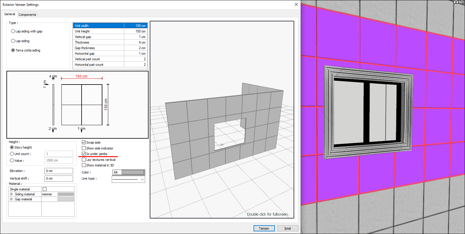

Jamb on the Exterior Veneer
When the "Is under jambs " option in the settings of the exterior veneer command is selected, it extends the siding element under the jamb element, up to the window/door gap. If not marked, finish the exterior veneer on the edge of the jamb, surrounding the jamb.
