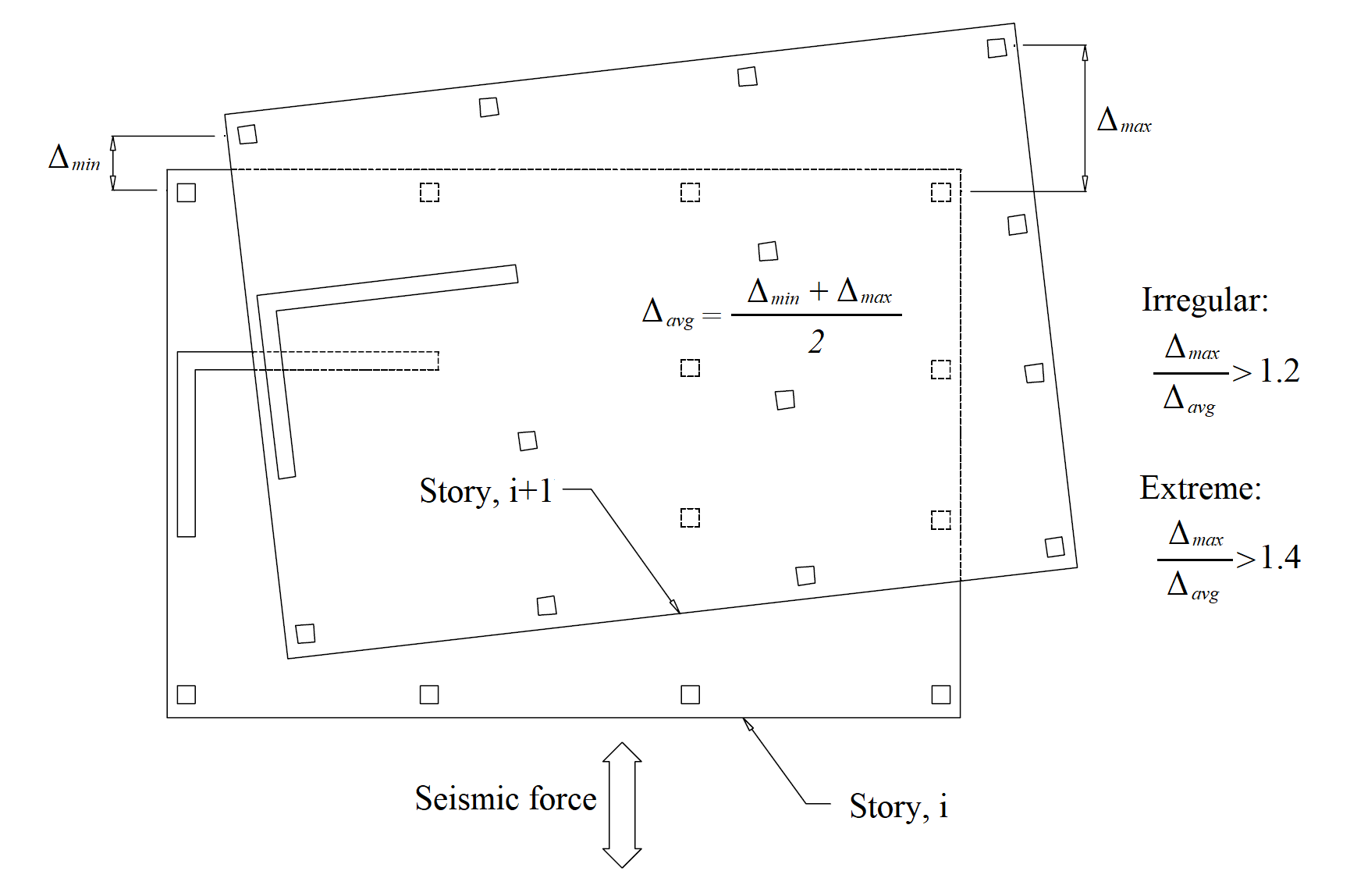

1a and 1b Torsional Irregularities per ASCE 7-16
SYMBOLS
Δavg = Average reduced relative story displacement on i'th floor of the building
Δmax = Maximum reduced relative story displacement on i'th story of the building
Δmin = Minimum reduced relative story displacement on i'th story of the building
1a - Torsion Irregularity
The Torsional Irregularity is defined to express the ratio of the maximum story drift, computed including accidental torsion with Ax =1.0, to the average relative story drift at the same direction is greater than 1.2. Torsional irregularity requirements in the reference sections apply only to structures in which the diaphragms are rigid or semirigid.
The calculation of the relative story displacements is made according to equivalent lateral force analysis, taking into account the ± 5% additional eccentricity effects.
1b - Extreme Torsional Irregularity:
Extreme torsional irregularity is defined to express the ratio of the maximum story drift, computed including accidental torsion with Ax =1.0, to the average relative story drift at the same direction is greater than 1.4. Extreme torsional irregularity requirements in the reference sections apply only to structures in which the diaphragms are rigid or semirigid.
