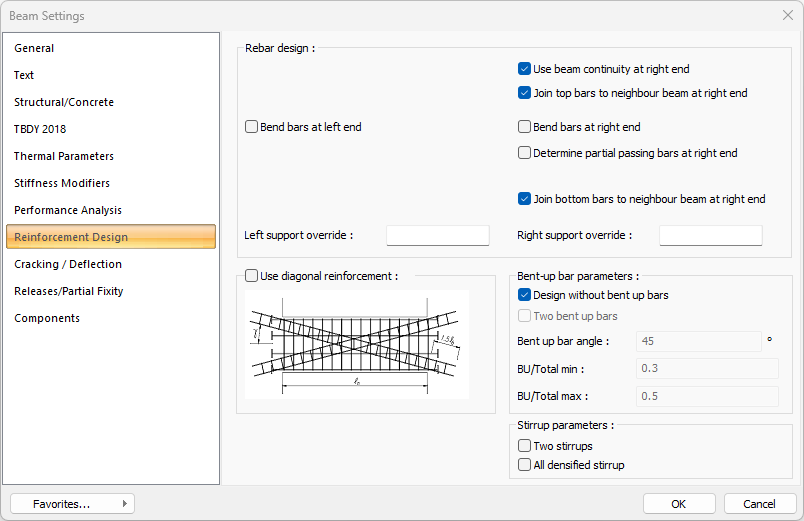

Design Beams With/Without Bend Up Bars
In concrete beam design, beam longitudinal reinforcements are chosen with and without bent-up bar. In the Beam Settings dialog, reinforcement design tab, there is a  "Design without bent up bars"  design option.
If the option is selected, the beam is designed without bent up bars, if the option is not selected, the beam is designed with the bent up bars.
