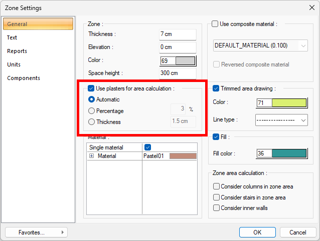

With the Use plasters for area calculation feature in the zone settings, it is ensured that the plasters are taken into account in the area area calculation. When the feature is activated, plasters will be taken into account and the area value will change.
Location of the Use Plasters for Area Calculation Feature
You can access the Use plasters for area calculation feature in the zone settings dialog.
Automatic
If it is automatically marked, the area between the wall plaster and the wall is deducted from the zone area while calculating the zone area and the area value found is written on the zone.
Percentage
If the percentage is marked, while calculating the zone area, the zone area is deducted as the percentage of the value written in the "Percentage" line and this value is written on the zone.
Thickness
If the thickness is marked, while calculating the zone area, the plaster thickness is taken into account as the value entered in this line and the area between the plaster and the wall is deducted from the zone area. .

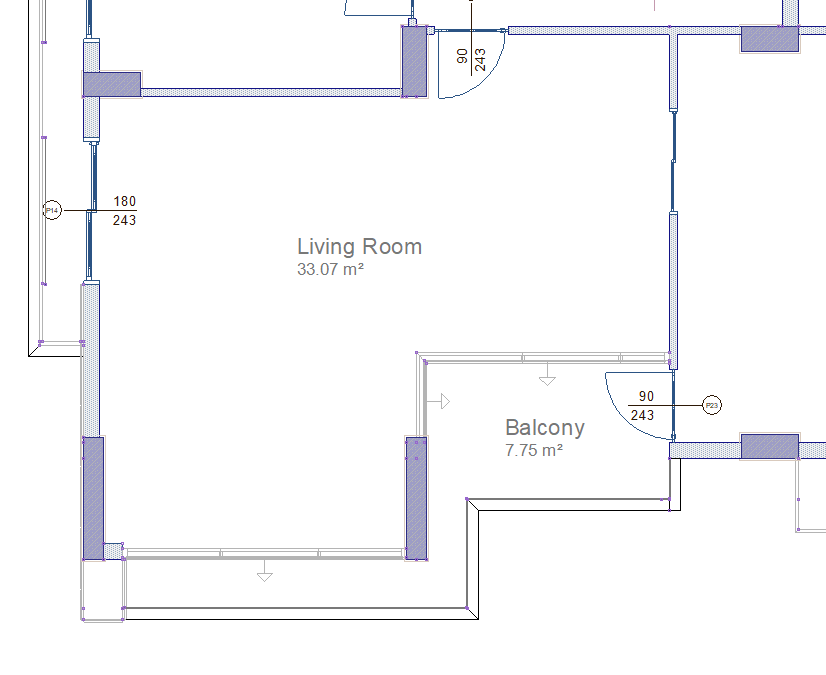

When use plasters for area calculation feature is not active
When use plasters for area calculation feature is active
Zone Edge
