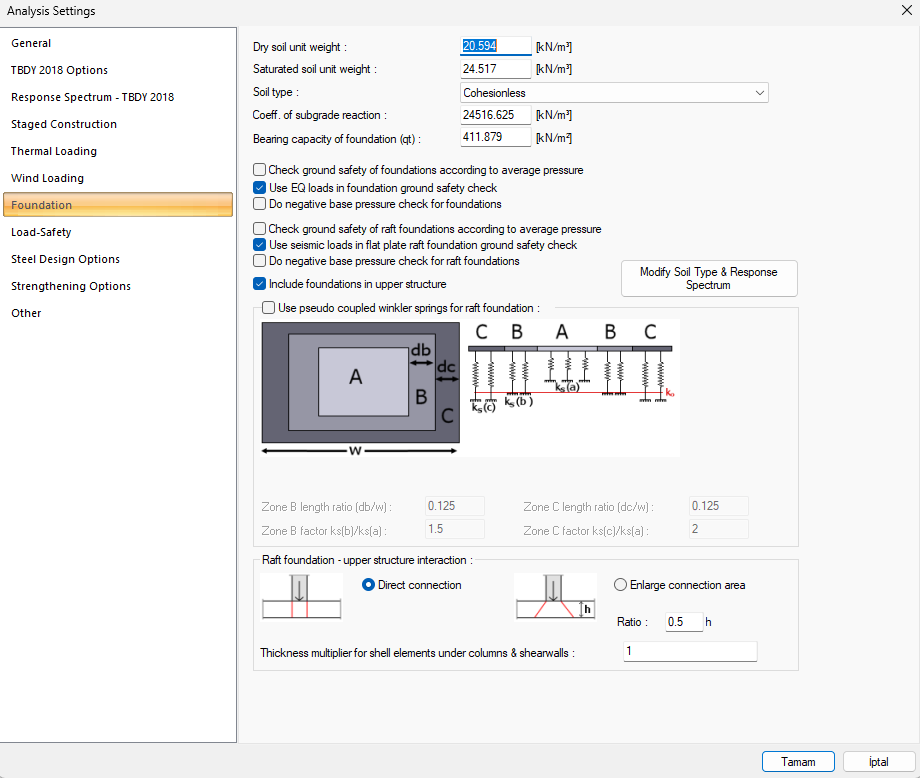

The upper structure - foundation- soil interaction can be selected from foundation tab of the analysis settings.
If the upper structure - foundation - soil interaction’s not selected, the structure considers to be fixed at the base.
