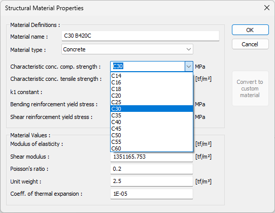

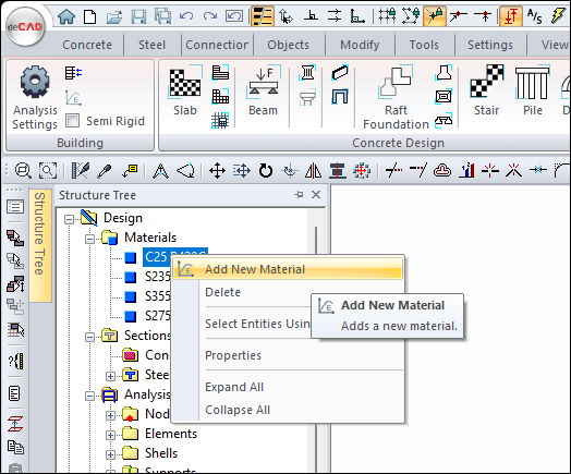

  • Define C25 or higher concrete class and assign it to reinforced concrete elements.

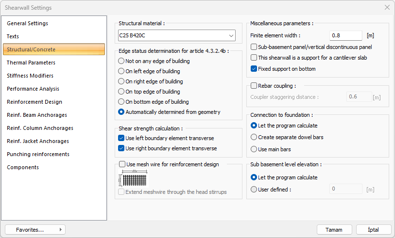

The new concrete class can be defined from the building tree.
Assigning concrete class is done in the properties of the elements, in the Structural/ concrete tab, from the structural material list.
