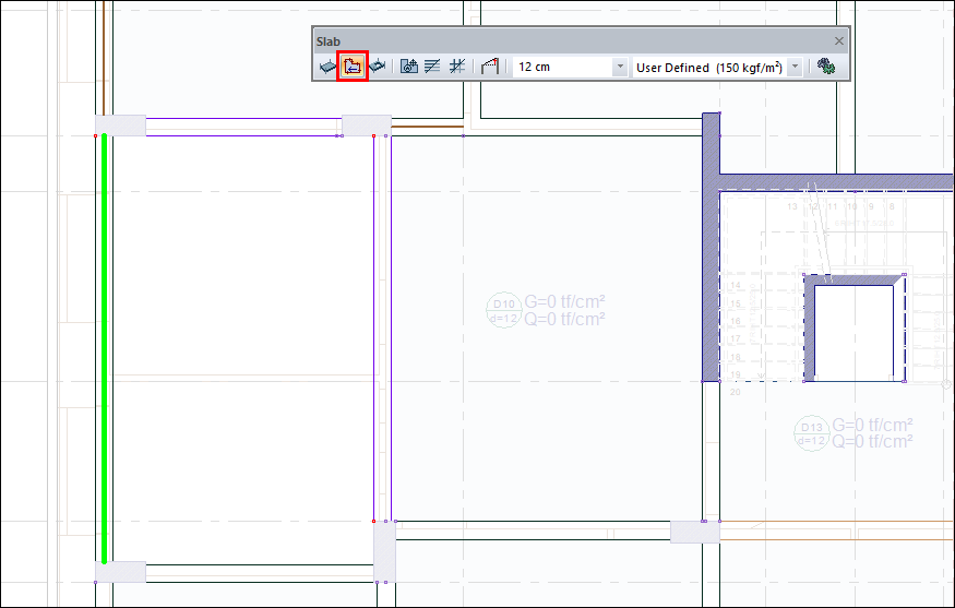

A slab is created by defining its boundaries with the command "Create Free Mode Slab".
  • From the slab toolbar,  select the create free mode slab icon.
  • Select the beam objects around the area you want to create a slab.

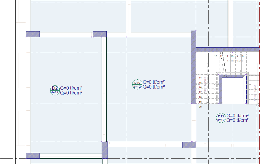

  • When you select the last beam and a closed area is formed, your slab will be formed.
