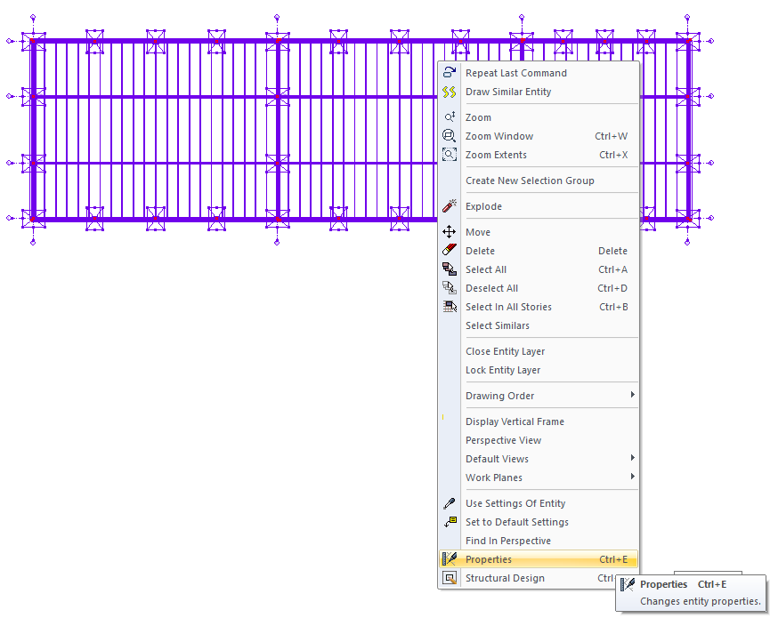

Location of the Brace Feature
Select the hall you want to brace and click the right mouse button. Click the Properties line from the right click menu that opens.

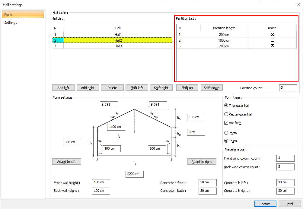

  • Enter the hall settings.
  • Select the hall you want to define brace from the list of halls.
  • Select the section you will define brace and check the brace box.
  • To remove the existing brace, uncheck the brace box for that partition.
  • Your diagonals will be formed according to the arrangement you made.

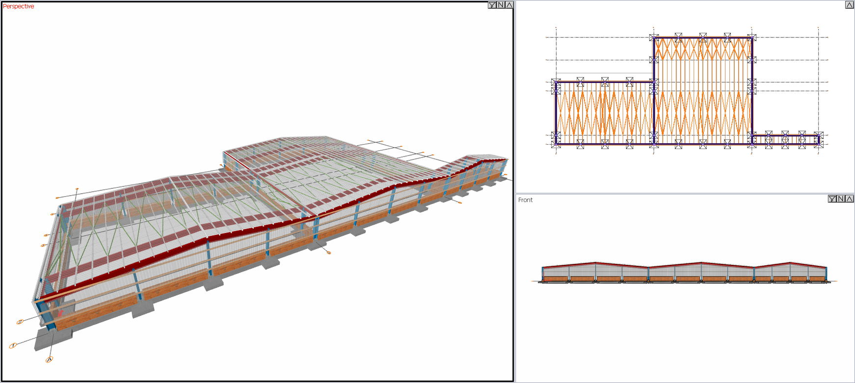

Status of halls when brace defined in partition 1, 3 and 5

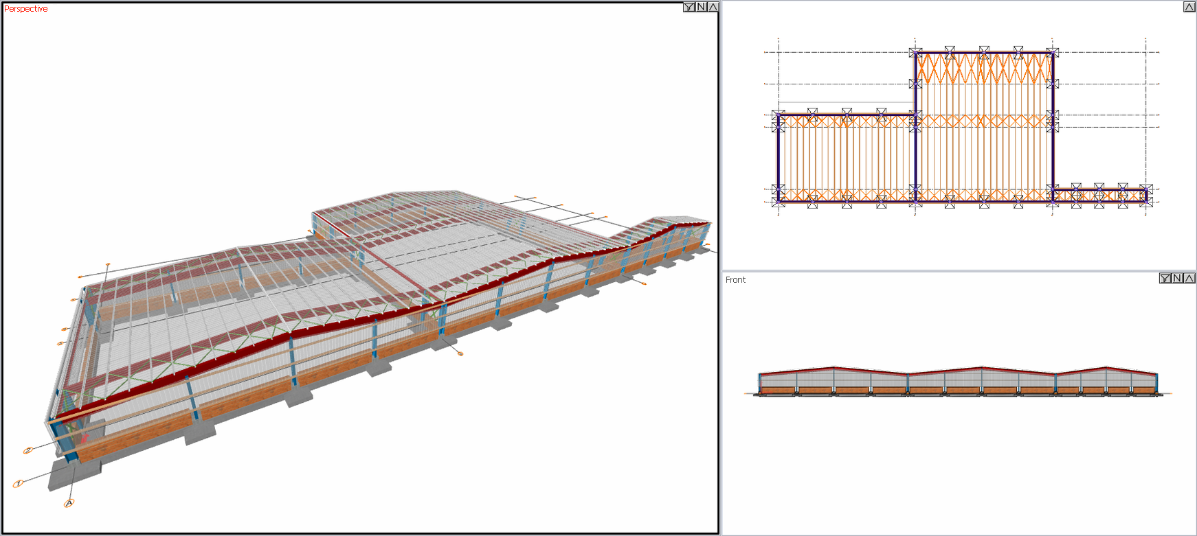

Status of halls when brace defined in partition 2 and 5
