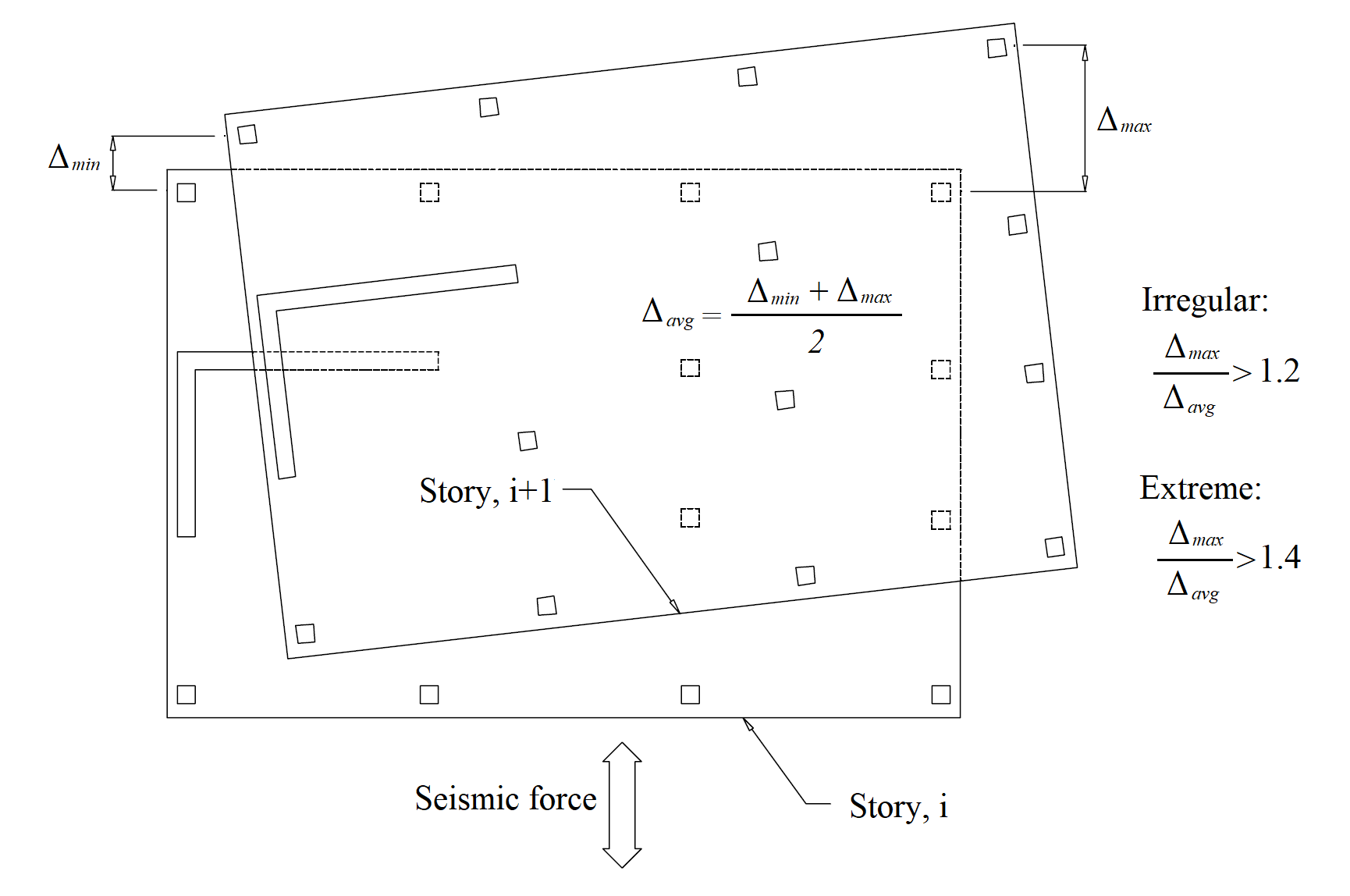

Δavg = Average reduced relative story displacement on i'th floor of the building
Δmax = Maximum reduced relative story displacement on i'th story of the building
Δmin = Minimum reduced relative story displacement on i'th story of the building
1a - Torsion Irregularity
The case where the Torsional Irregularity Factor, which is defined for any of the two orthogonal earthquake directions as the ratio of the maximum story drift at any story to the average relative story drifts at the same story in the same direction, is greater than 1.2. Maximum story drift, computed including accidental torsion with Ax =1.0. Torsional irregularity requirements in the reference sections apply only to structures in which the diaphragms are rigid or semirigid.
This type of irregularity affects the Selection of Linear Calculation Method described in Section 12.6 of ASCE 7-16. However, ideCAD Static has already used Linear Dynamic Analysis (Modal response analysis and modal superposition method in time domain) specified in Section 12.9.
1b. Extreme torsional irregularity
Extreme torsional irregularity requirements in the reference sections apply only to structures where the diaphragms are rigid or semirigid.
