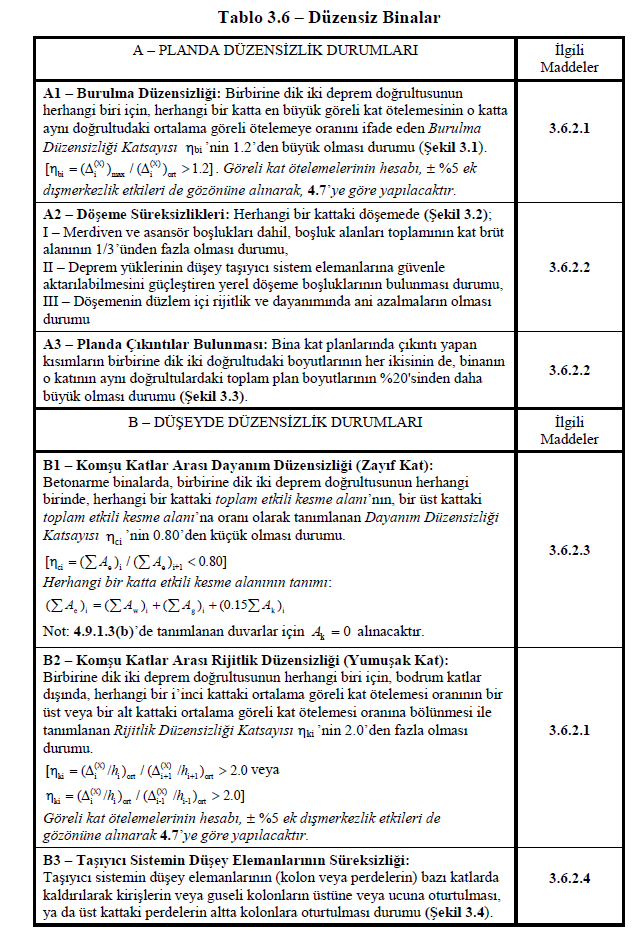

  • Equivalent earthquake load method is used only in irregularity calculations and these checks are made automatically.

  • ideCAD Statik uses this account automatically only for irregularity calculations .
