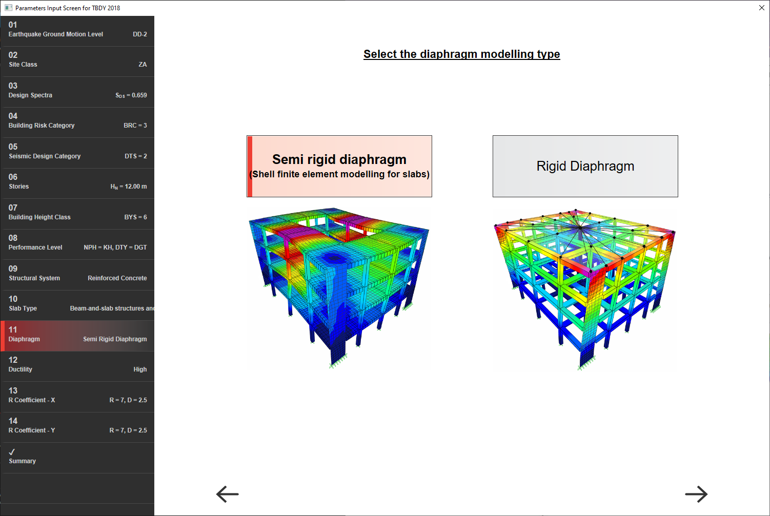

The slab analysis model is determined in this step. The Rigid Diaphragm option is not allowed to be selected in the wizard for one way ribbed slab and flat slab.
Related Topics
Related Topics
