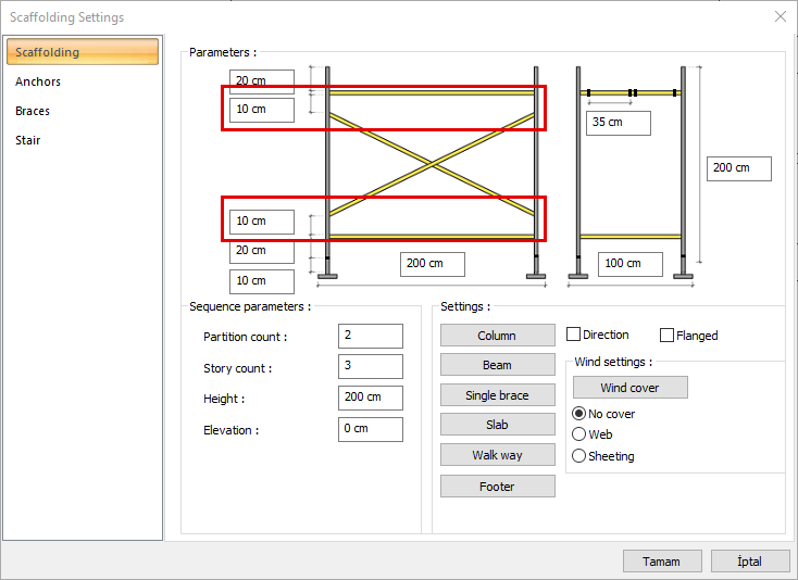

Select the scaffolding for which you want to change the brace corner points and click the right mouse button. Click Properties from the right-click menu that opens .
  • Enter the scaffolding settings dialog.

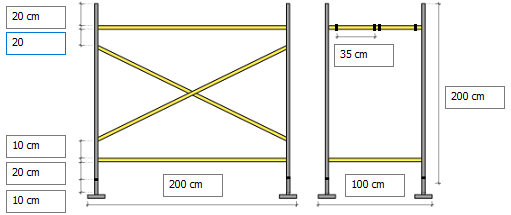

  • In the brace upper corner point box, enter the distance to the top beam.
  • In the brace lower corner point box, enter the distance value to the bottom beam (walkway).
  • According to the value you enter, the location of the lower and upper corner points of the brace will change.

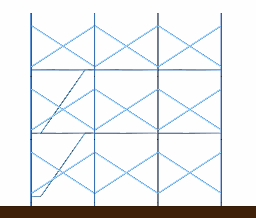

Scaffolding view before relocating brace corner points
Scaffolding view after changing brace upper corner point location value to 20 cm
Scaffolding view after changing brace corner point location value to 20 cm
