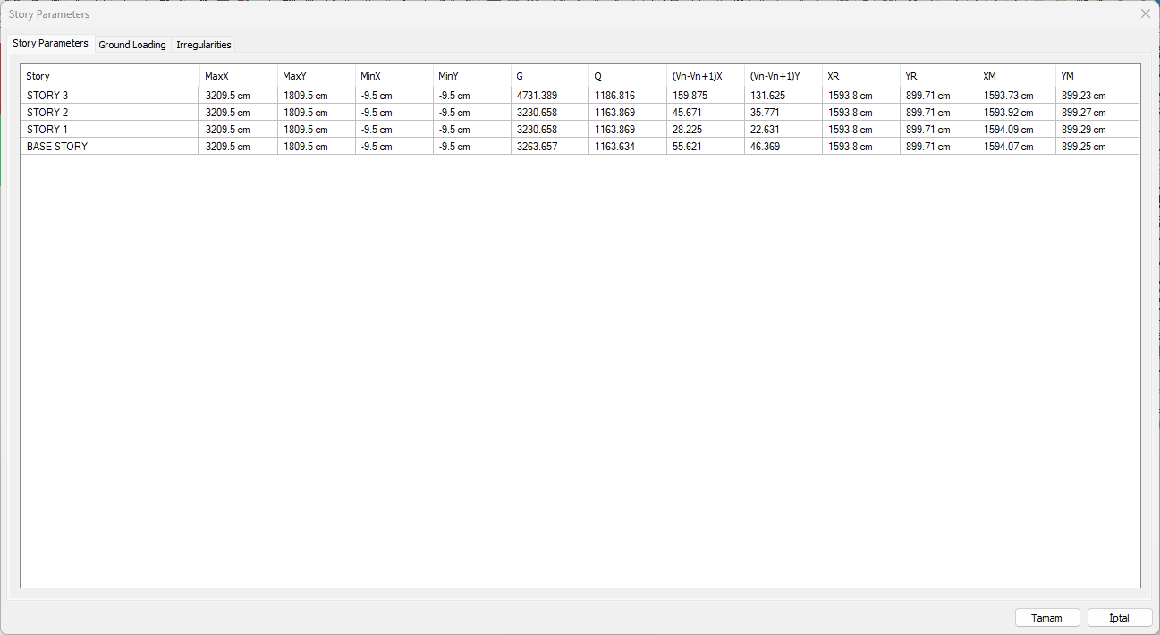

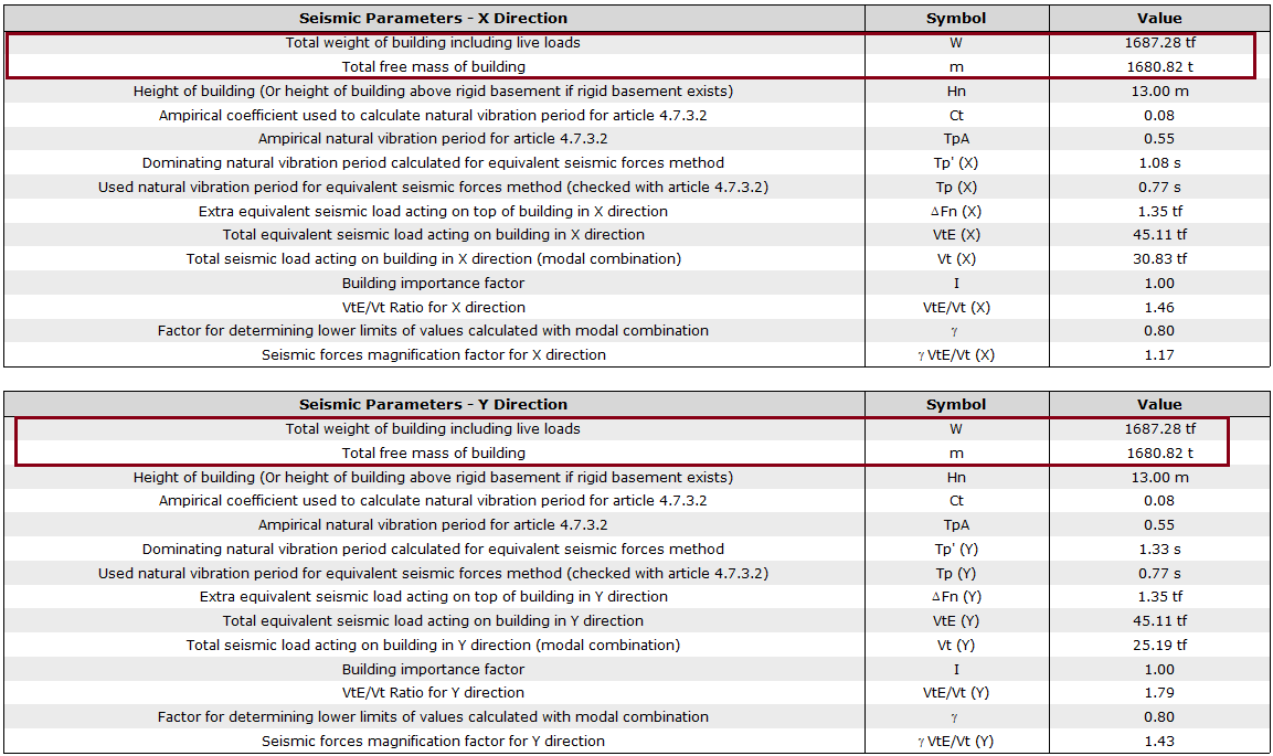

  • The damping ratio is taken as 5% according to TBDY 2018 4.5.1.3.
