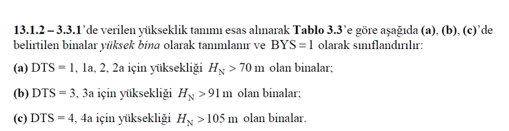

The design of high-rise buildings is made in 3 design stages within the rules given in TBDY Chapter 13 . If your building is Hn = 130m, it is defined as a tall building and classified as BYS = 1. You can also see this classification from the TBDY Wizard in ideCAD.
637cbed6-e486-4c3e-b478-576137c47e03#media-blob-url=true&id=41ab3968-9a94-44c1-8547-45b1c0ee3f7f&collection=&contextId=43712&mimeType=image%2Fpng&name=image-20211027-115139.png&size=44168&height=185&width=720
In TBDY Chapter 13 , it is said that 3 stages should be done for high-rise building design.

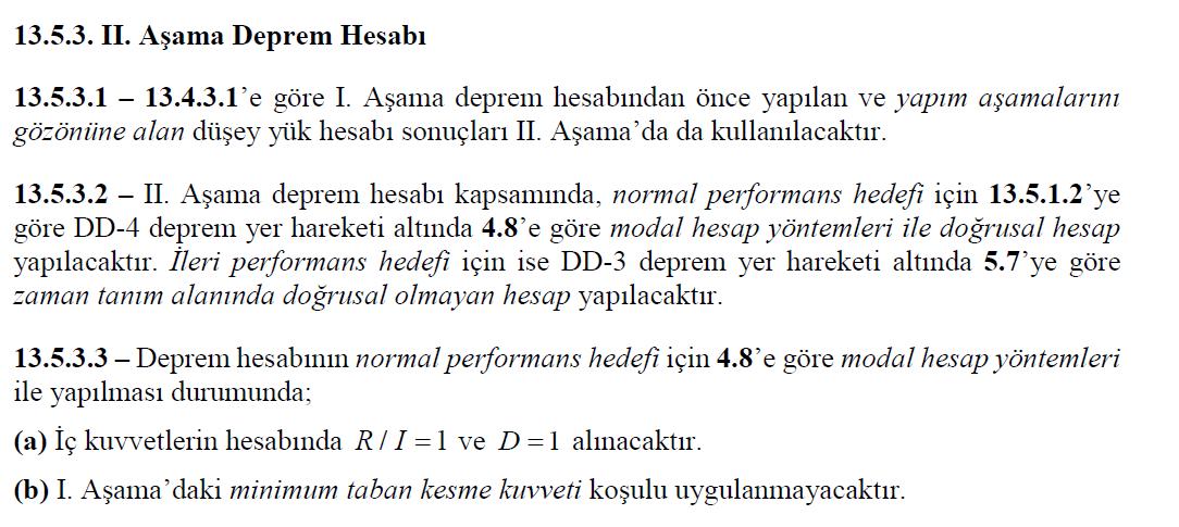

The second stage should be evaluated for a DD-4 or DD-3 Earthquake Uninterrupted Use Under Ground Motion or Limited Damage Performance Target. There is no automatic definition in the program for this stage. For the second stage calculation, linear analysis can be done with modal calculation methods in the normal performance target. However, for this, you have to define all the conditions stated in 13.5.3 yourself. Taking R = D =1, DD-3 earthquake level definition, spectrum curve change given for damping rate…
