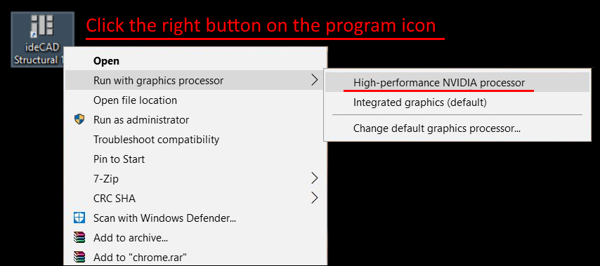

Run with a Graphics Processor
If there is a graphical slowness in the perspective view on notebook computers, the onboard graphics card may be active on your computer.
For this, activating the higher performance graphics card with the right button menu while running the ideCAD will solve the problem.
