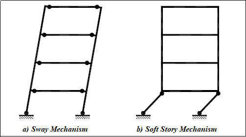

    Column must be stronger than beams in order to prevent brittle collapse, except for the intended mechanism.
  • In the figure (a) the sway mechanism is the preferred system, while (b) the soft story mechanism is not desired. As can be seen in figure (b), when the hinges are formed at the ends of the columns, this is a situation that leads to brittle collapse.
