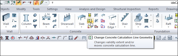

Location of Change Concrete Calculation Line Geometry Command
You can reach it under the Concrete tab in the ribbon menu under the Concrete topic heading.
  • Click the Change Concrete Calculation Line Geometry icon.
  • Select one of the account line on the slab.
  • Determine the new position of the account line and click the left button.
  • The operation will be completed.

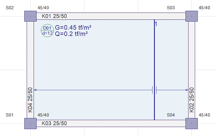

Before changing concrete calculation line geometry

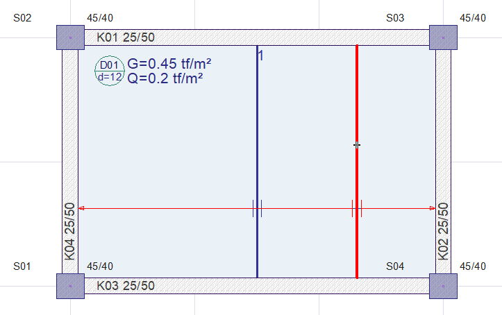

Choosing one of the calculation line on the slab
Determining the new position of the calculation line and clicking the left mouse button

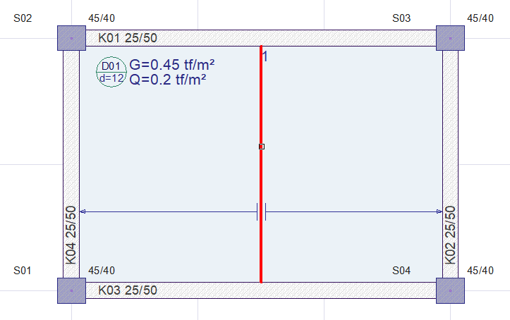

Concrete calculation line geometry after changing
