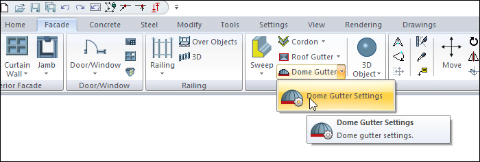

Location of Dome Gutter Settings Command
You can access it under the 3D Geometric Objects title of the Ribbon menu, Facade tab.

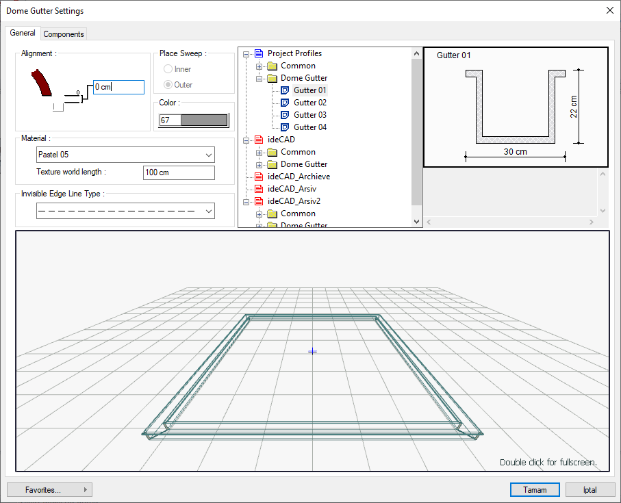

Alignment
The position of the dome gutter relative to the roof is adjusted. The dome gutter is drawn as much as the height entered from the upper end of the dome eavies.
Select the color of the dome gutter from the dialog that opens when clicked.
Select the material (texture) of the surfaces of the dome gutter from the drop-down list for the solid model.
Texture length of the material used is entered into the texture world length. For example; If 1 is entered, the selected material texture width is taken as 1 unit and covered on the relevant walls. Considering that the texture is in the form of a square, the object surfaces are covered with 1x1 textures arranged side by side. It can be determined separately for each surface.
Invisible edge line type
Select the linetype of the background lines from the list. You can cover (invisible) any edge of the roof gutter. You may want to make the line types of the edges that you make invisible, different from other edges.
Project profiles
It is the list of profiles for the dome gutter. The selected profile will be used in the enclosure. Profile preview is drawn on the right.
Schematic section
Includes the measured drawing of the selected section.

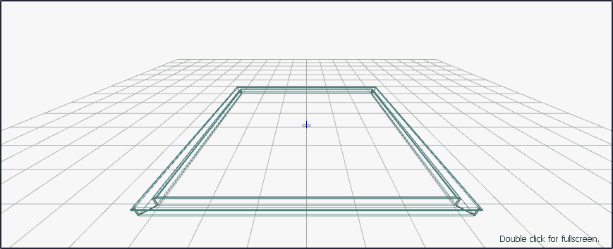

3D preview
It is a 3-dimensional view of the dome groove. You can rotate the image around itself by holding down the left mouse button and moving it. You can zoom in and out by holding the right mouse button and moving the mouse.

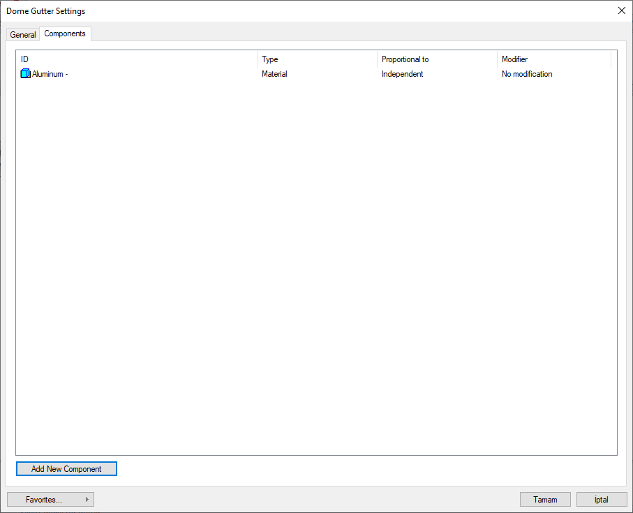

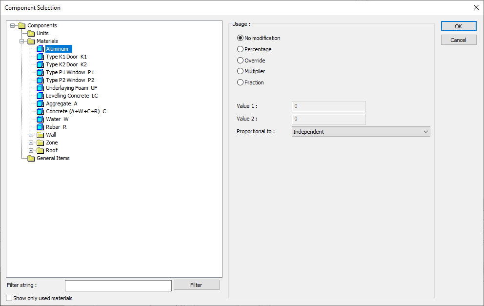

Components Tab
In the usage section
Dome Gutter
Measure
Listed
Explanation
Constant
Independent
Length
Independent
Length
It means that the length of the material will be found by multiplying the length measure found when defining the material and the length of the dome gutter.
Area
Independent
Outside area
It means that the area measure found while defining the material will be used by multiplying it with the dome gutter outside area.
Volume
Independent
Volume
It means that the volume measure found when defining the material will be used by multiplying it by the volume of the dome gutter.
Count
Independent
The count measure found while defining the material will be used exactly as the material number.
Count
It means that the count measure found while defining the material will be multiplied by the number of dome gutter.
