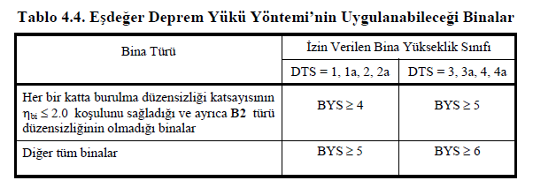

4.6.2.2 - Buildings to which the Equivalent Earthquake Load Method , details of which are explained in 4.7 , can be applied are given in Table 4.4 .
