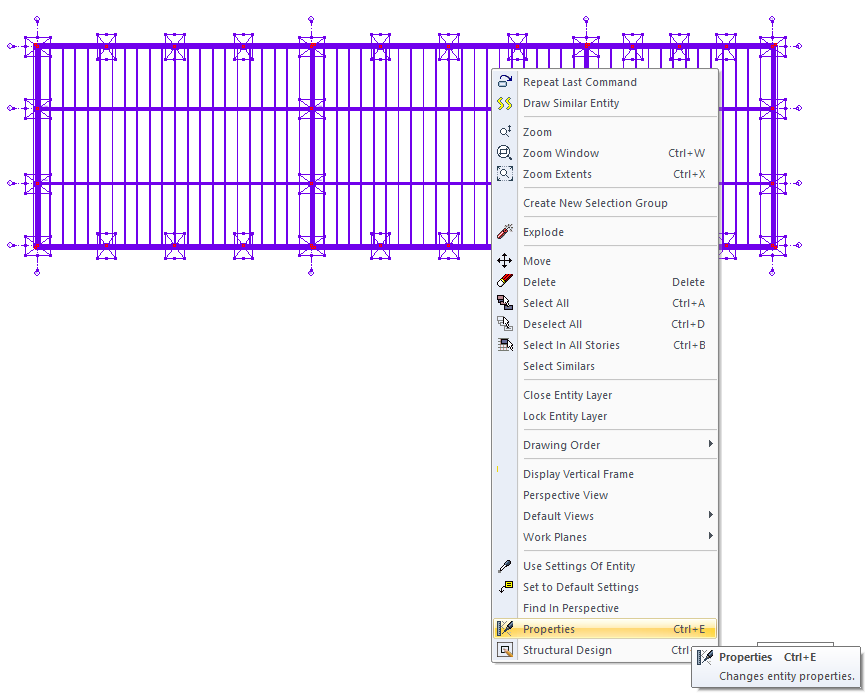

Location of the Partition Count Box
Select the hall and click the right mouse button. Click the Properties line from the right click menu that opens.

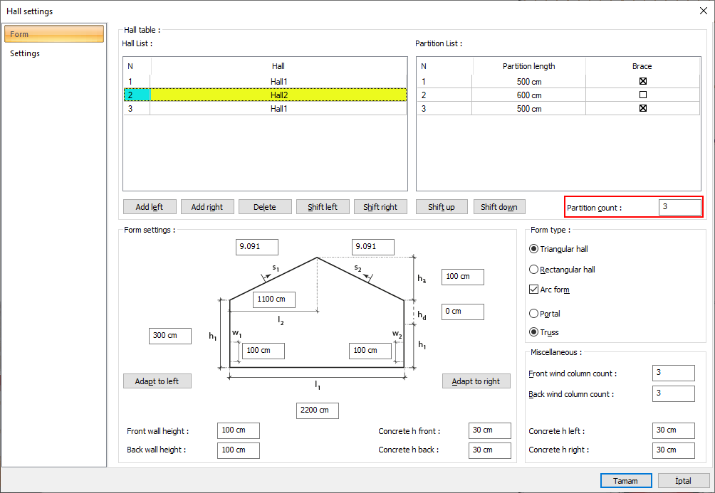

  • Enter the hall settings.
  • Select the hall for which you want to change partition count from the list of halls.
  • Give it a new value.
  • Hall will be formed according to the value you give in the hall you choose.

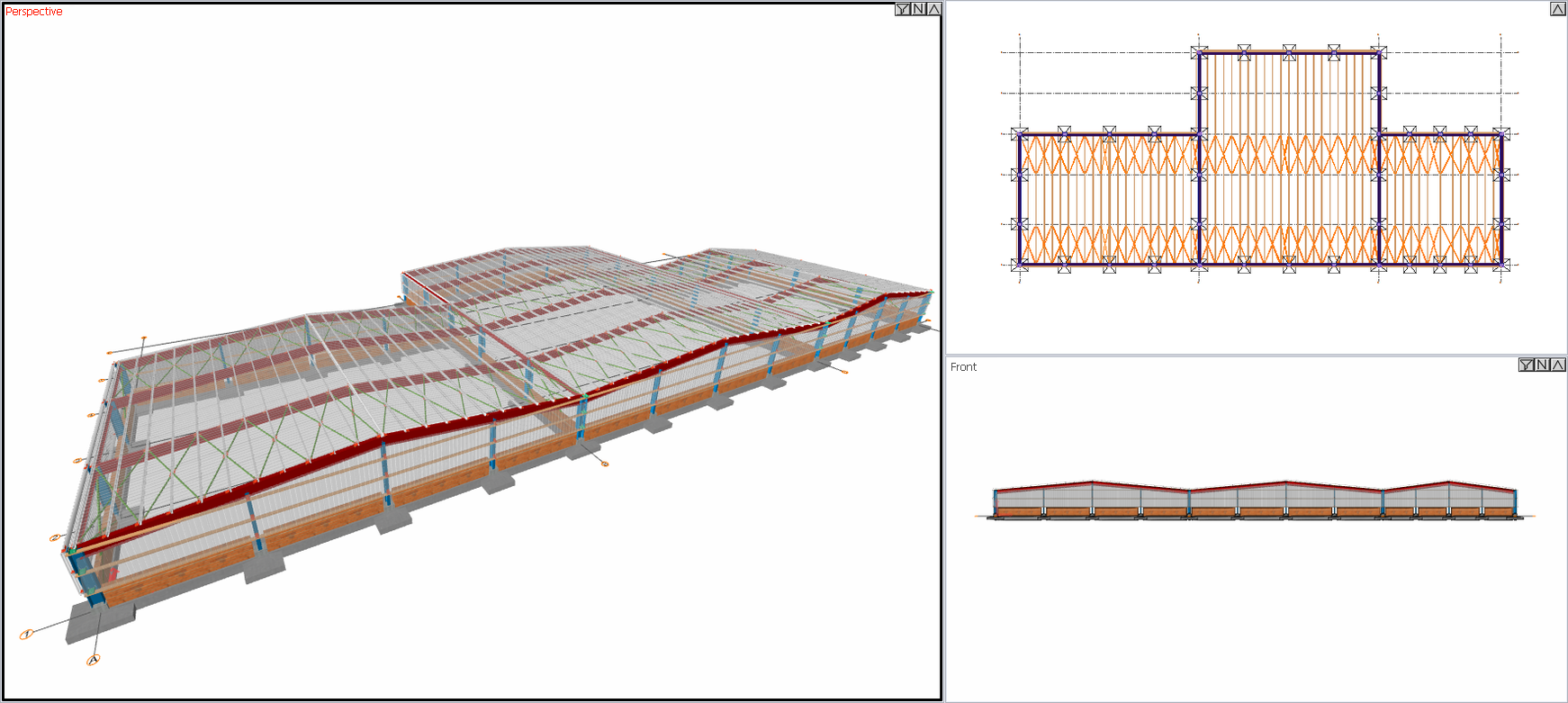

Status of halls when the count of partitions is 3

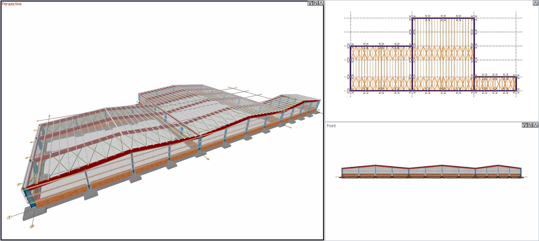

When the count of hall 2 partition is 5, the status of halls

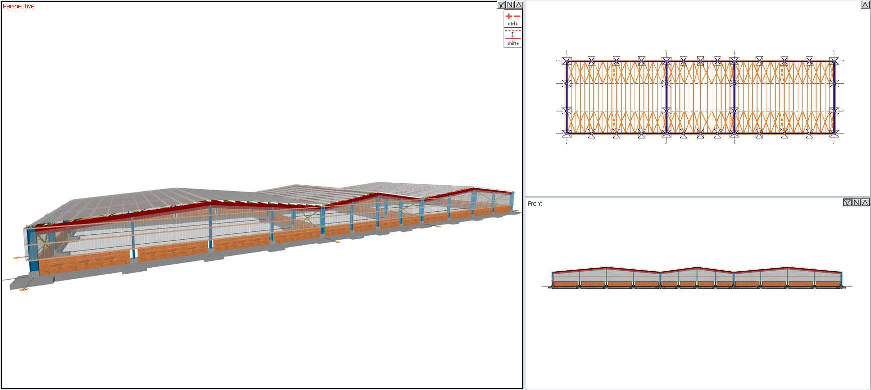

When the count of hall 3 partition is 1, the status of the halls
