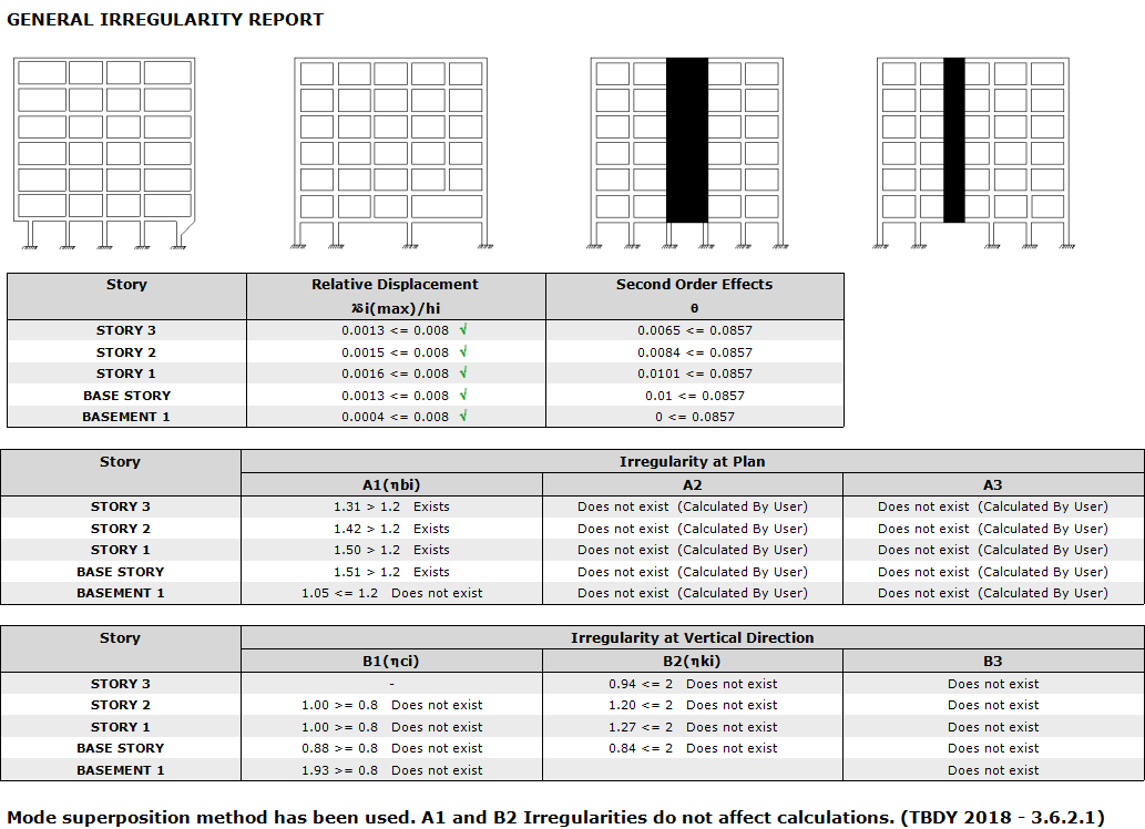

I'm getting an A1 and B2 irregularity warning. What should I do?
A1 and B2 types of irregularities are the irregularities that determine the reason for the selection of the calculation method. In the case of dynamic analysis, these irregularities have no provision. In the program, dynamic analysis is done under all conditions and the situation is printed in reports.
