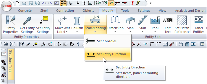

You can access it from the ribbon menu Modify tab under the Entity Edit heading.
  • Click the set entity direction icon.

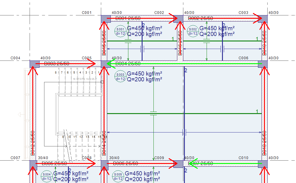

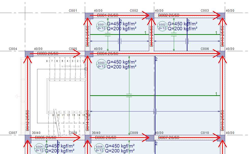

  • Select the beam whose direction you want to change. When the arrow that appears along the beam is reversed and its color changes from red to green; the direction of that beam changes.
  • You can also select multiple beams whose direction you want to change.
  • Press ESC to exit the command.

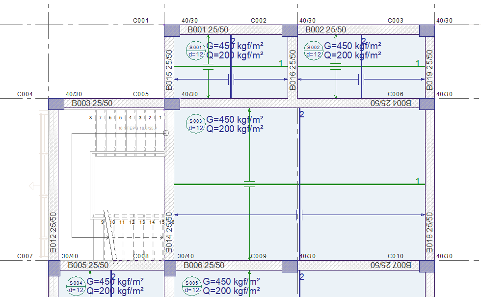

  • You will see that the beam texts, therefore the beam are turned upside down.
Beams before entity direction is changed
Beams with entity directions
Selecting the beams to be diverted

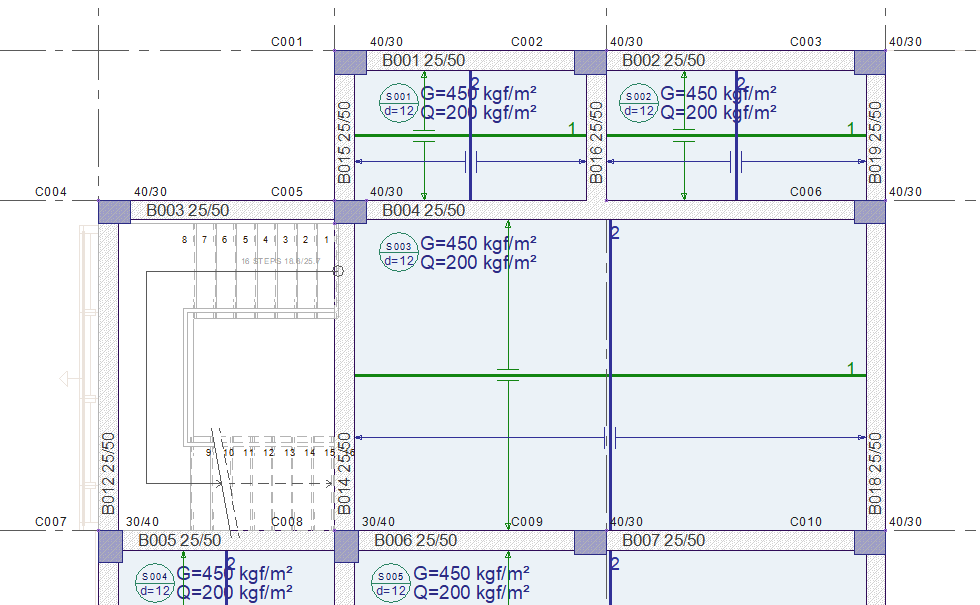

Beams after entity direction is changed
The beam and strip directions are not architecturally significant. However, it is important in terms of structural continuity.
