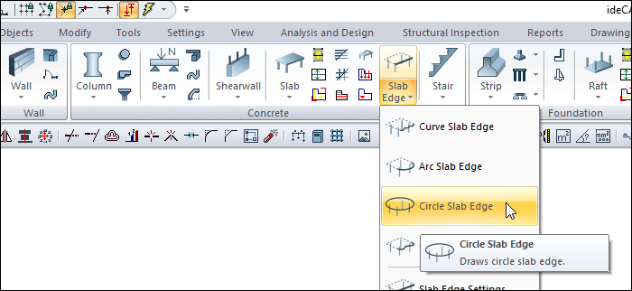

You can access it under the Concrete tab in the ribbon menu under the Concrete heading.
  • Click the circle slab edge icon.

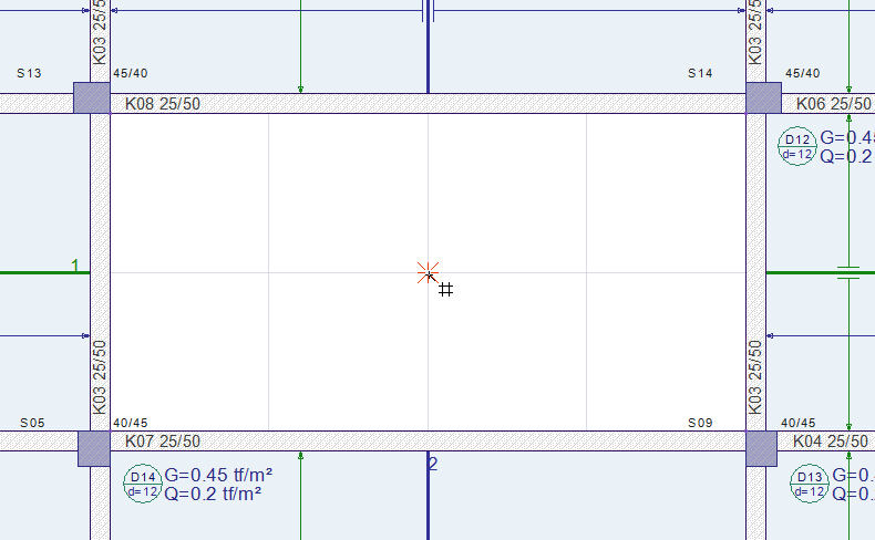

  • Click the point you have set as the center with the left mouse button.

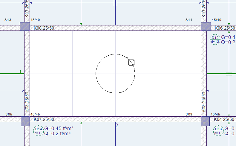

  • When you move the mouse, a circular form will appear at the tip of the cursor.
  • After determining the radius of your circle, click the left mouse button.

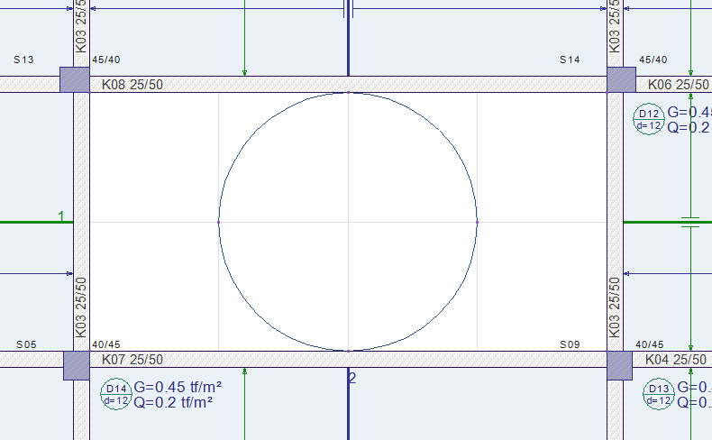

  • A circle slab edge will form.

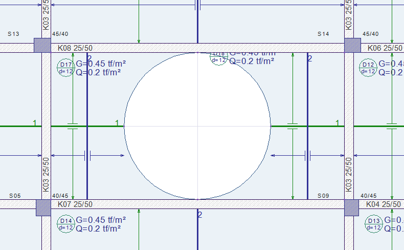

  • Exit the command by pressing the Esc key on the keyboard. You can now define slab.

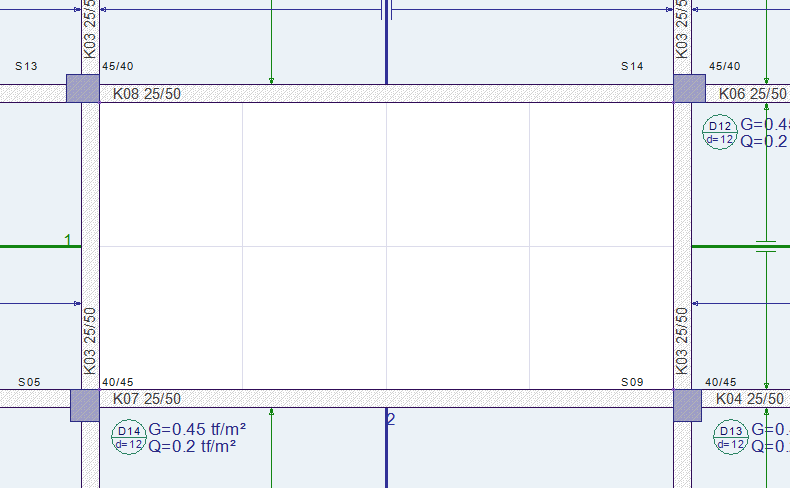

Area to draw a circle slab edge
Determining the center of the circle slab edge
Creation of circular form preview
Determining the radius of the circle slab edge
Formation of circle slab edge
The area after the slab is created
