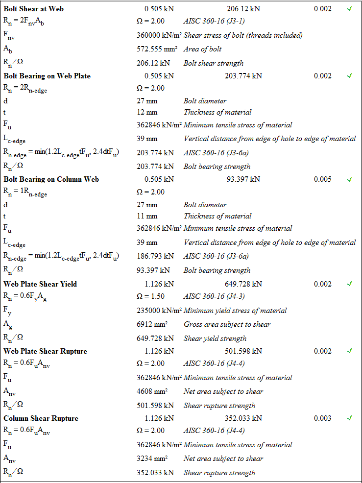

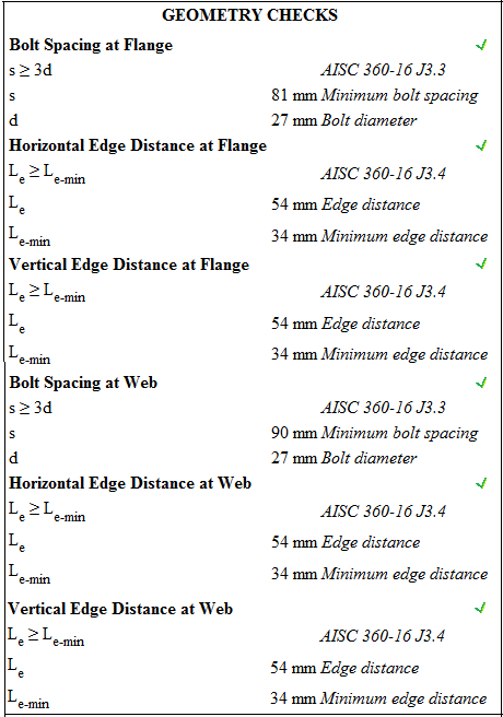

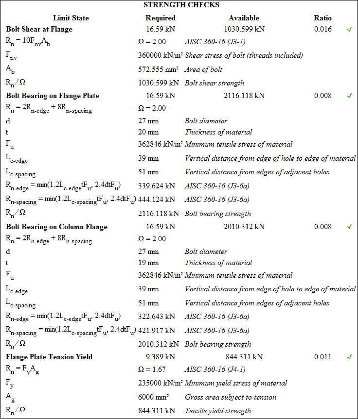

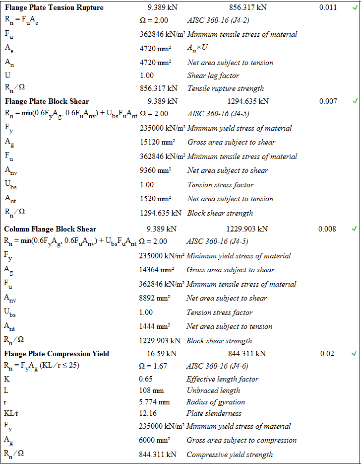

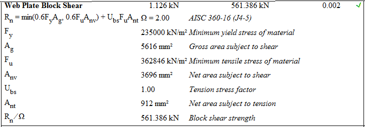

Splice Connection Design Report
A sample of Column/Beam splice connection design report according to AISC 360-16 is given below.
  • Column/Beam splice connection design limit states and geometry checks are done automatically according to AISC 360-16.
