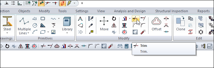

Location of the Trim Command
You can access the trim command under the ribbon menu Drawings tab , under the Modify heading.
  • Click the Trim icon in the ribbon menu .
  • Select the line that will be your reference border and click the right mouse button.
  • Identify the side of your other line to be cut.
  • Your line will be trimmed.

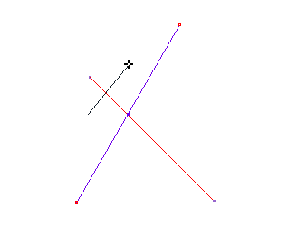

Usage Step
Determining the reference limit

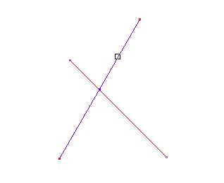

Determining the side to be cut

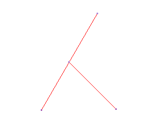

After trim
