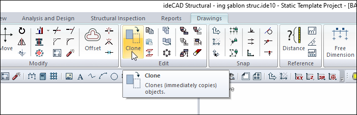

Location of the Clone Command

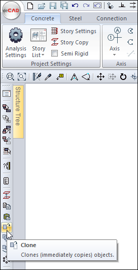

Clone command can be run from the toolbar on the left side of the program.
In addition, the Drawings tab is available under the Edit heading.
  • Click the Clone icon on the left toolbar.

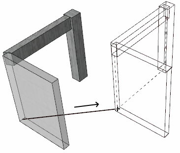

  • Select the object or objects and click the right mouse button.
  • Give the base point you want with the left mouse button.
  • Drag the mouse and click the left button again.
  • The object will be cloned.
  • Press the left mouse button again to clone the serial.

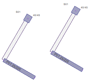

Selecting objects and giving reference point during clone command

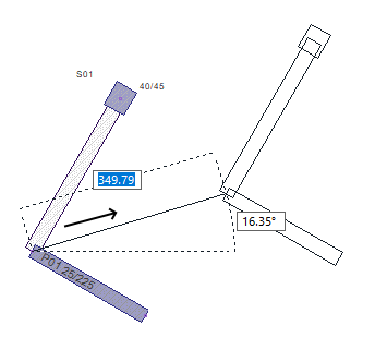

Drag the mouse to the new point and give the final point for cloning

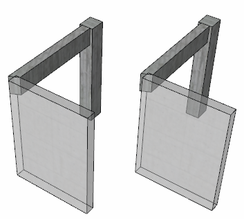

After cloning
