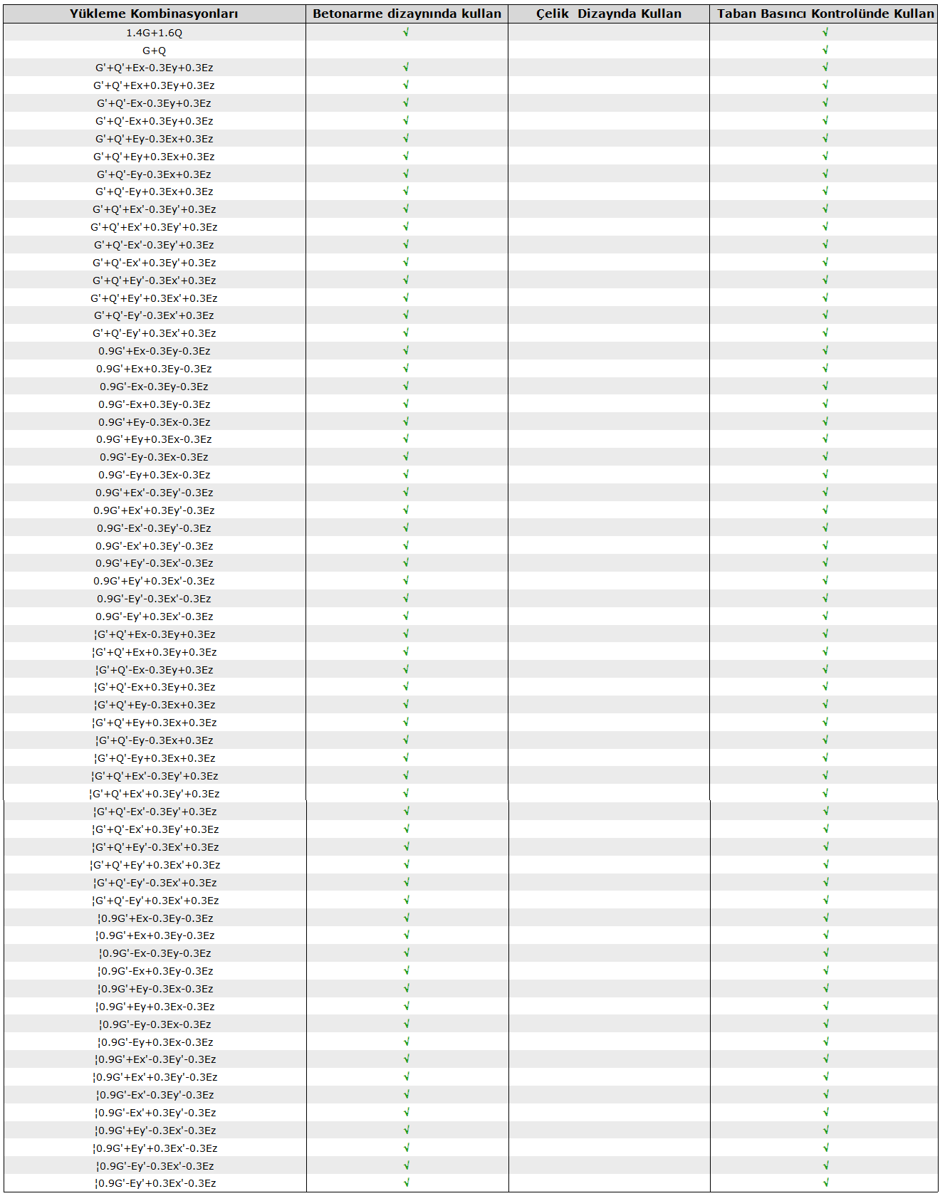

The loading combinations created automatically by the program using TS 500 and TBDY 2018 for the building can be checked from the Building Tree and Selective Report .
