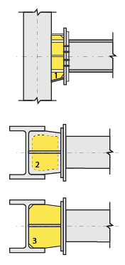

Defining a Column-Beam Stiffened End Plate Connection
With the Column-Beam Stiffened End Plate command, column-beam connection is defined.
Location of Column-Beam Stiffened End Plate Command

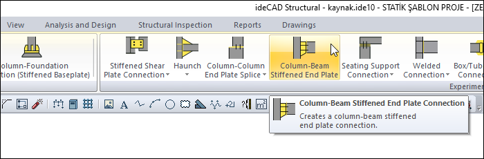

You can access it under the ribbon menu, Connection tab, Experimentals title.

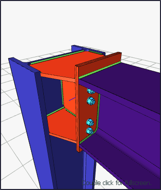

  • From the connection menu, click on the Column-Beam Stiffened End Plate Connection icon.
  • Click the elements you want to connect sequentially from the 3D perspective view.
  • The connection will occur.

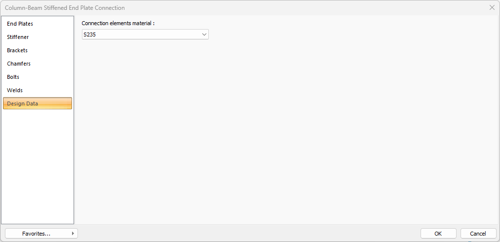

Location of the Column-Beam Stiffened End Plate Connection Settings Dialog

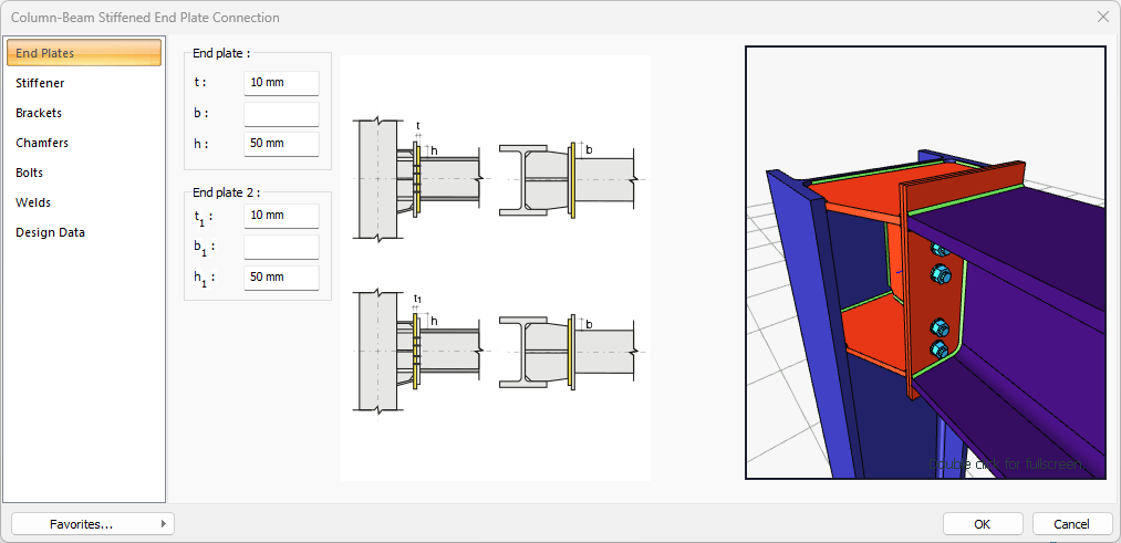

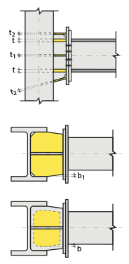

End Plates Tab
End plate
The end plate is determined by entering the values. The values ​​to be entered are shown in the schematic drawing.
End plate 2
The end plate 2 is determined by entering the values. The values ​​to be entered are shown in the schematic drawing.

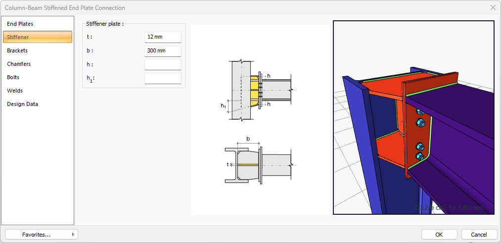

Stiffener Tab
Stiffener plate
It is determined by entering the values ​​of the stiffener plate. The values ​​to be entered are shown in the schematic drawing.

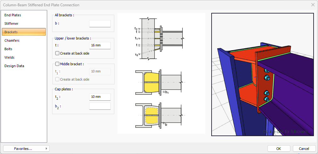

Brackets Tab
Brackets
Brackets are determined by entering values. The values ​​to be entered are shown in the schematic drawing.
Cap plates
Cap plate is determined by entering values. The values ​​to be entered are shown in the schematic drawing.

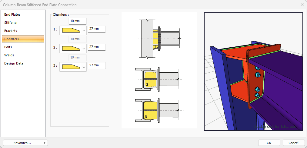

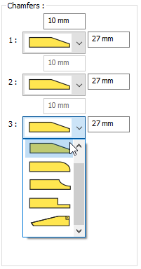

Chamfers Tab
Chamfers
Connection values ​​are shown on the schematic drawing.

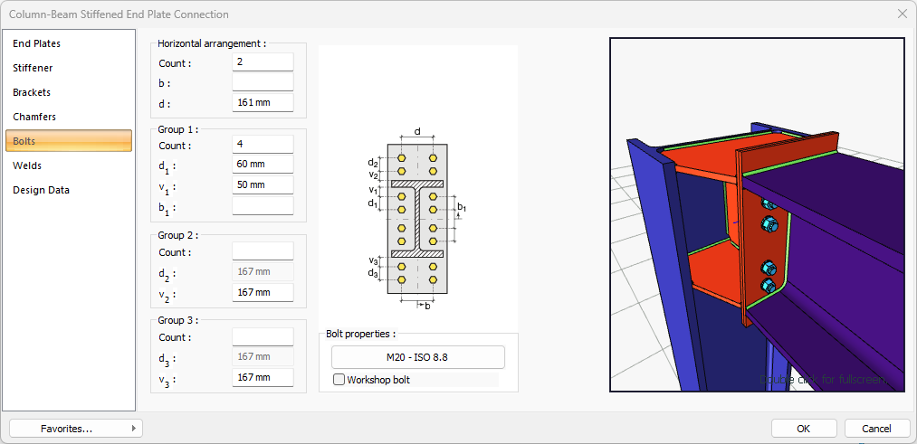

Bolts Tab
Horizontal arrangement
The horizontal count of bolts and the arrangement distance value are entered. The values ​​to be entered are shown in the schematic drawing.
Group 1
The number of bolts, distance values ​​to beam and other bolts are entered. The values ​​to be entered are shown in the schematic drawing.
Group 2
Group 3

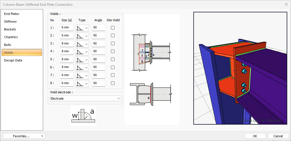

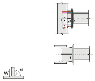

Welds Tab
Welds
Weld electrode
Design Data Tab
