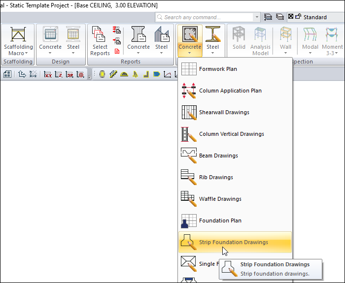

Location of the Strip Foundation Drawings Command
You can access it under the ribbon menu Concrete tab, Create Drawing heading.
  • Click on the line Strip Foundation Drawings.
  • The drawing properties dialog will open.
  • Make the edits you want and click the OK button.
  • The strip foundations will be automatically designed according to the scale and paper size specified in the drawing settings. One or more strip foundation drawings windows can be created according to the fit in the paper. The relevant window can be selected from the list under the Window menu.

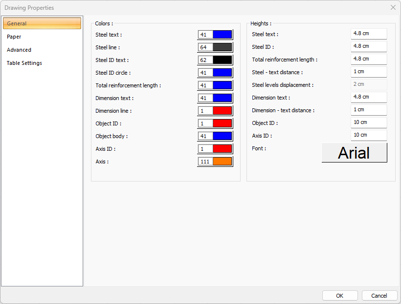

General Tab
Specifications - Colors
Steel text
Steel line
Steel ID text
Steel ID circle
Total reinforcement length
Dimension text
Dimension line
Object ID
Object body
Axis ID
Axis
Adjusts the color of the axis. When the color box is clicked, the appropriate color is selected from the window that opens.
Specifications - Heights
Steel text
Steel ID
Steel - text distance
Steel levels displacement
Dimension text
Dimension - text distance
Object ID
Axis ID
Font

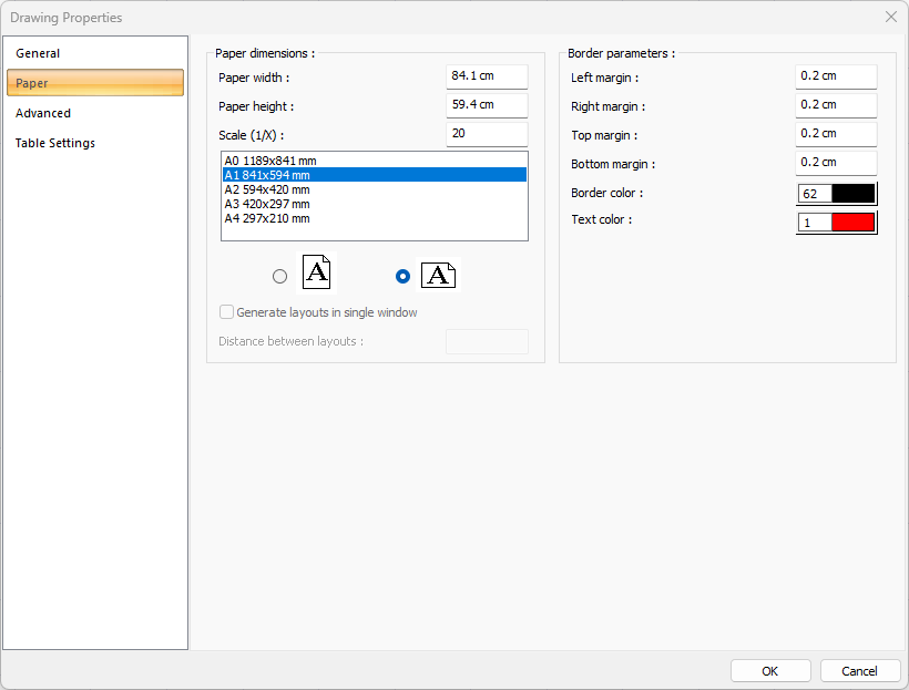

Paper Tab
Paper width
Paper height
Scale (1/X)
Standard paper sizes
Vertical/Horizontal use
Distance between layouts
Left margin
Right margin
Top margin
Bottom margin
Border color
Text color

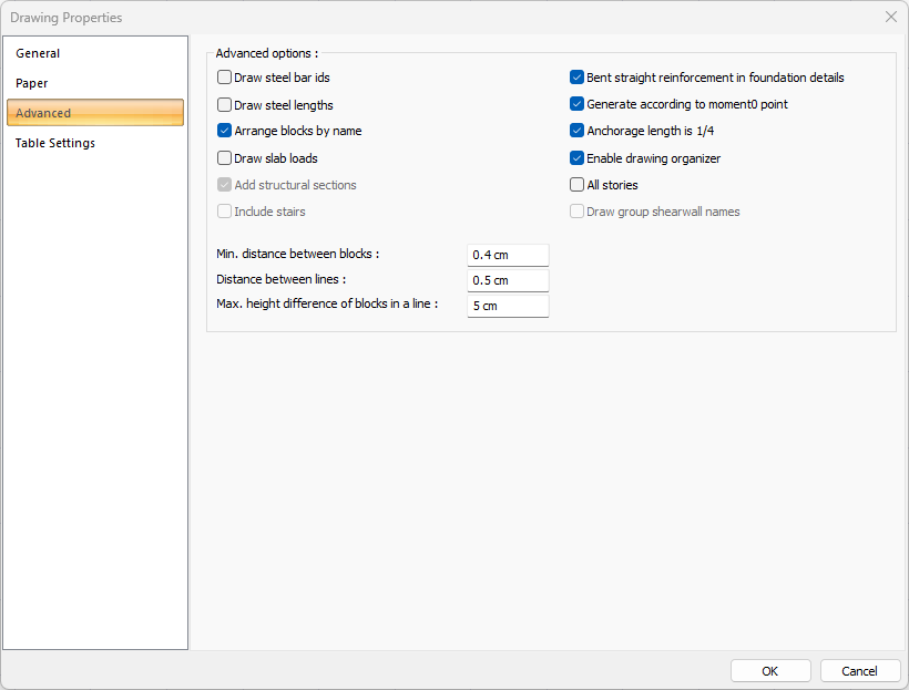

Advanced Tab
Draw steel bar ids
Draw steel lengths
Arrange blocks by name
Draw slab loads
Anchorage length is 1/4
Enable drawing organizer
All stories
Min. distance between blocks
Distance between lines

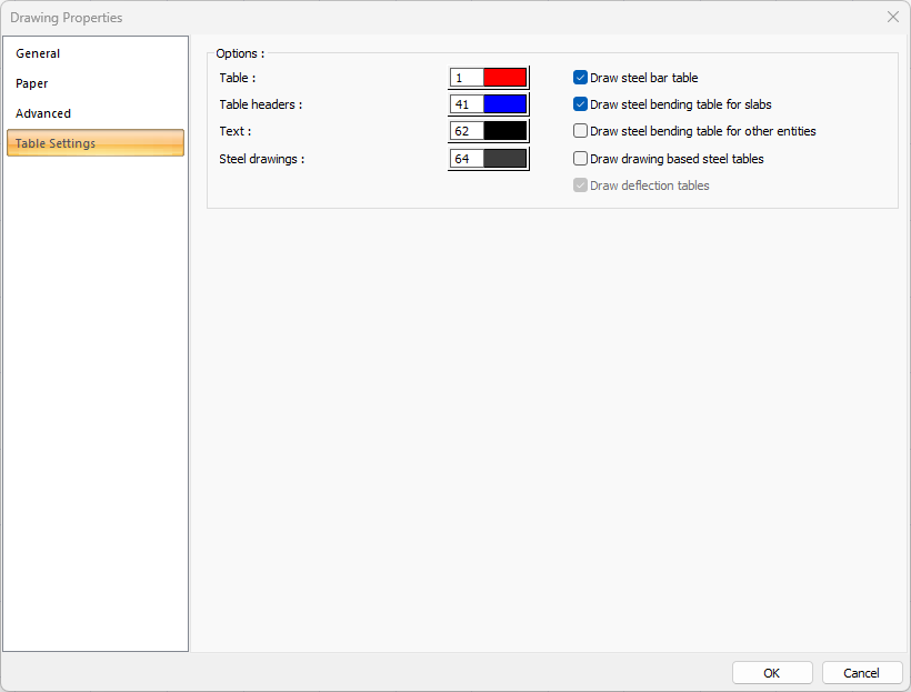

Table Settings
Table
Table header
Text
Steel drawings
Draw steel bar table
