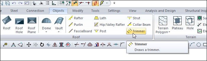

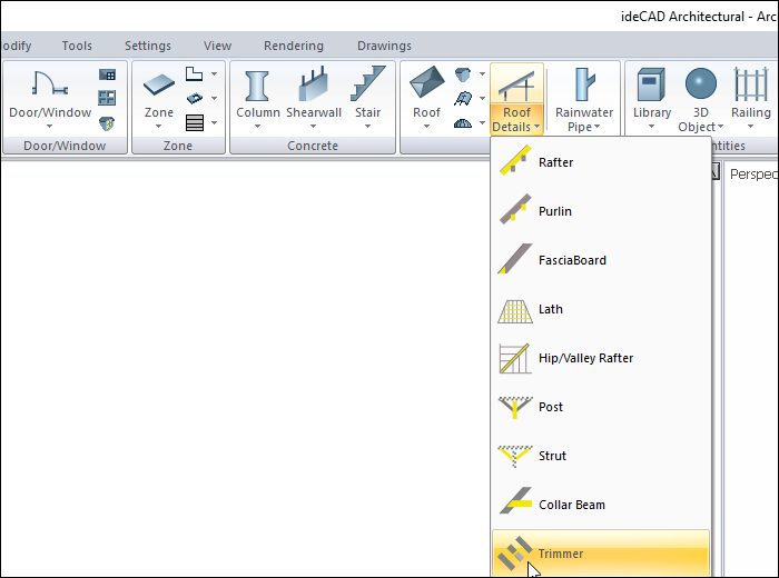

Location of Trimmer Command
In Structural Program

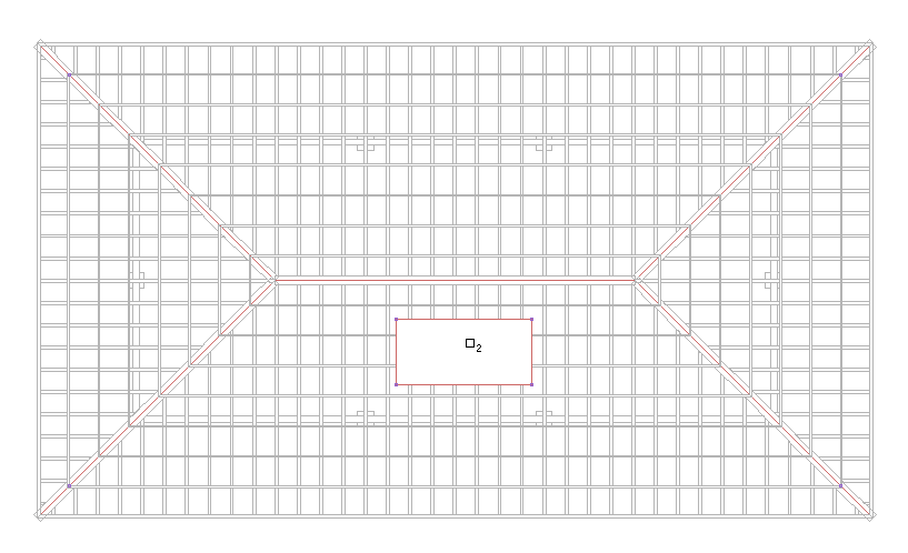

To draw a trimmer:
  • Click the Trimmer icon in the ribbon menu .

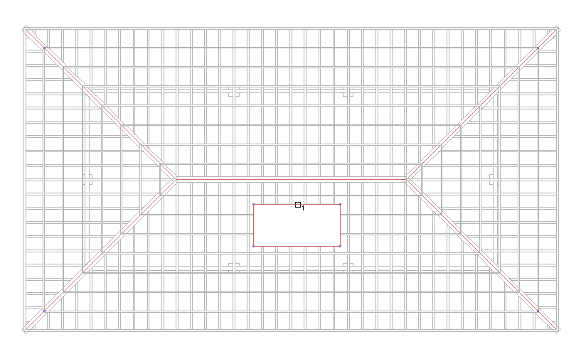

  • Click one of the roof opening edges with the left mouse button.

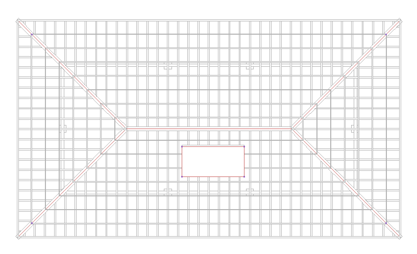

  • If you want the sheave beam to be the length of your chosen side, click on the inside of the roof opening. Enter the width and height of the trimmer section from the trimmer dialog that opens and click the OK button. A trimmer will be drawn on the edge of the relevant roof opening.

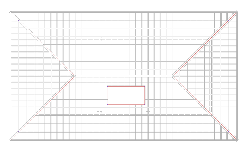

  • Build the other trimmer in the above process order.
Choosing one of the roof hole edges
Clicking inside the roof hole to have the trimmer at the selected edge length
Making the trimmer settings
Formation of trimmer
Formation of all trimmer for roof hole
