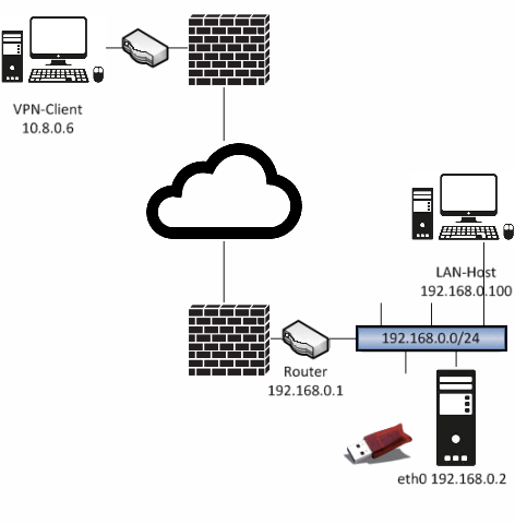

To connect to a HASP network dongle from an external network, it is necessary to provide each remote workstation with the IP address of the computer on which the dongle is attached.
For example, on a network with address 192.168.0.0/24, if the dongle connects to a server with address 192.168.0.2 (see below), the following operations will be performed on the IP 10.8.0.6 remote machine.

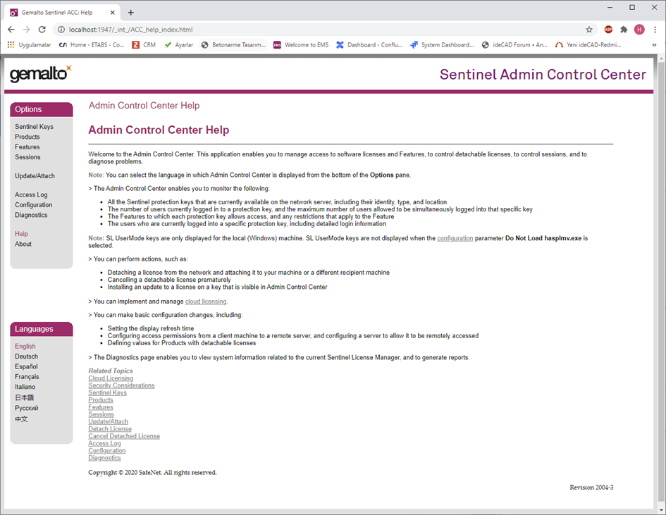

  • You can access the Sentinel Admin Control Center from any machine at http://localhost:47/ . The following screen will open.

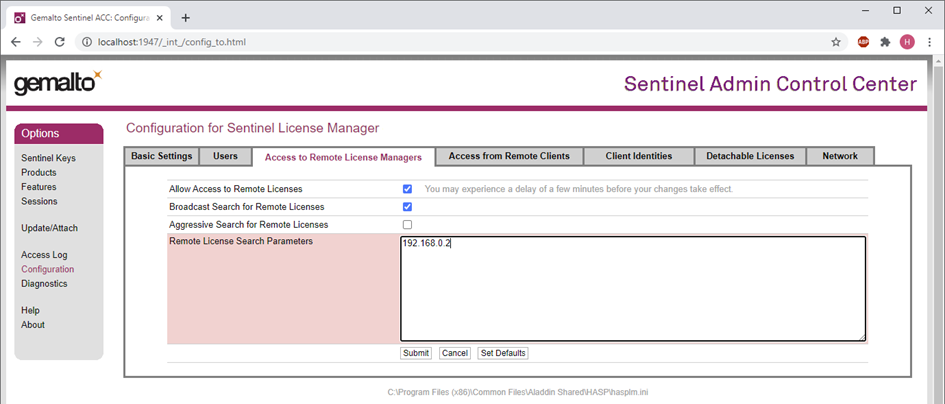

  • Under the "Configuration" menu, select "Access to Remote License Managers" and type the dongle machine's IP address (192.168.0.2 for this example).
  • Check the “Allow Access to Remote licenses” and “Broadcast Search for Remote Licenses” options.
  • Then confirm by clicking the "Submit" button.

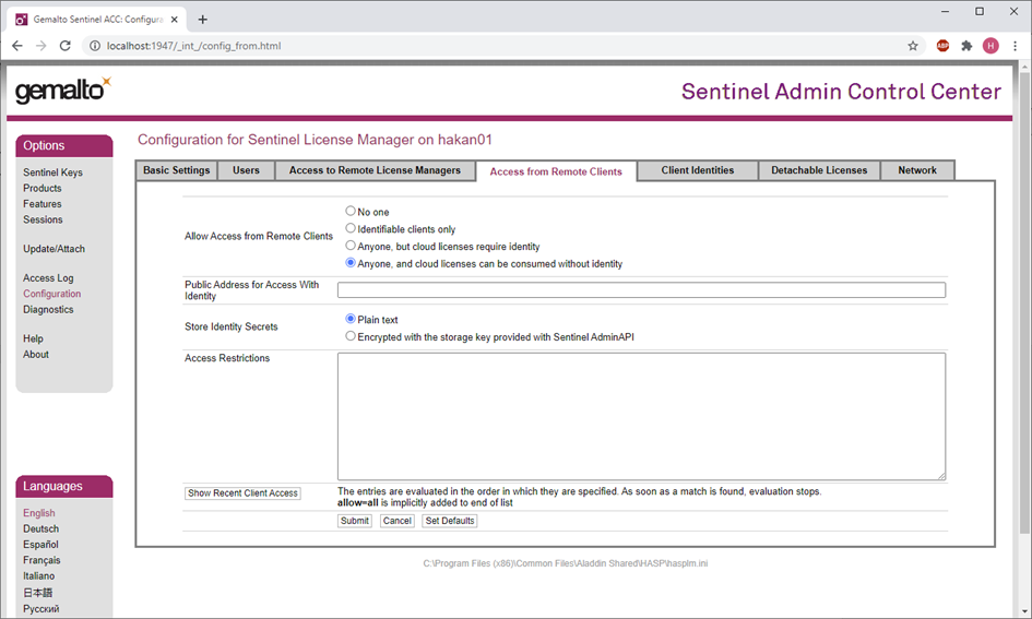

Configuration the Locked Host Computer
  • Enter the console with http: // localhost: 1947 / .
  • Select “Access from Remote Clients” under “Configuration” .
  • You should be able to see client computers in the “Show Recent Client Access” item.
