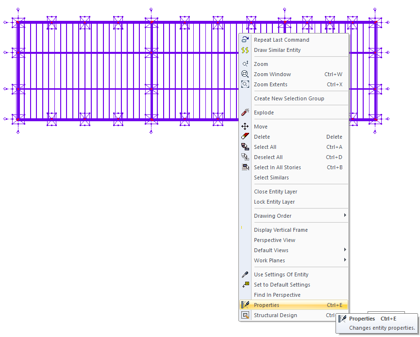

Select the hall and click the right mouse button. Click the Properties line from the right click menu that opens.

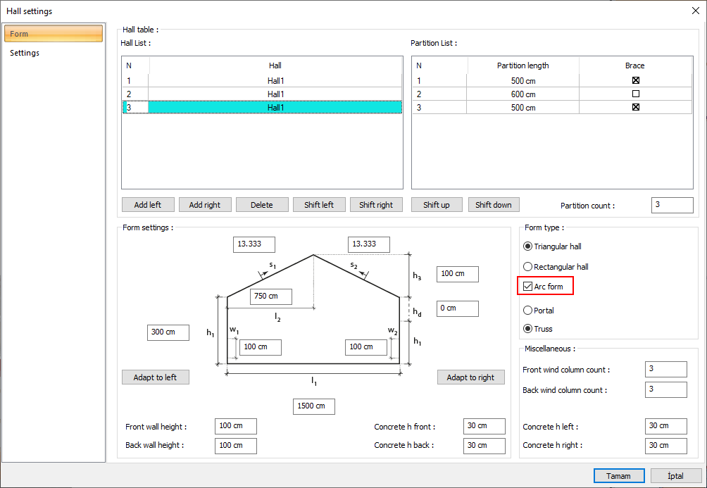

  • Enter the hall settings.
  • Select the hall you want to change the roof form for from the Hall list.
  • Check the arc form option in the form type section.
  • The hall you choose will be formed with the arc form type.

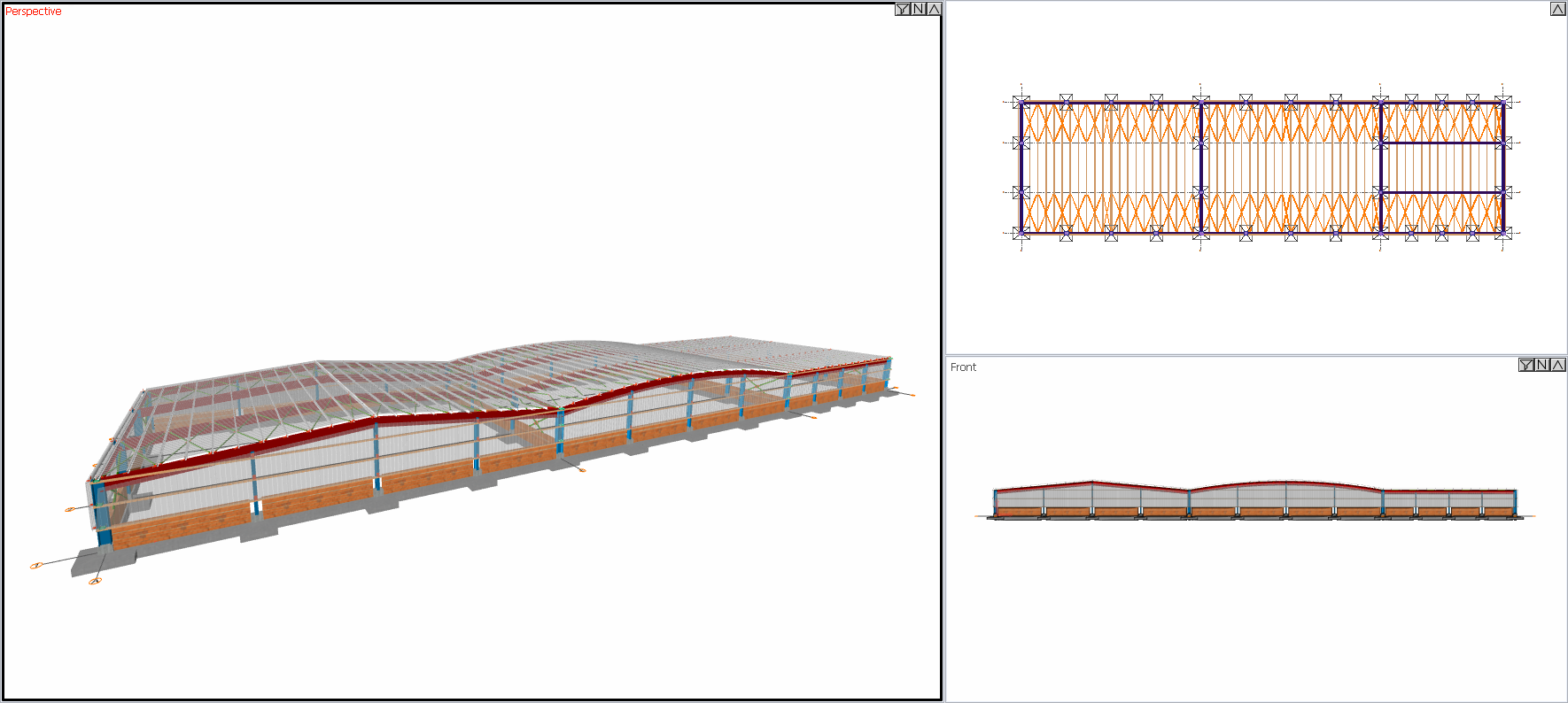

View of hall 1 triangular, hall 2 arc form and hall 3 with rectangular type selected
