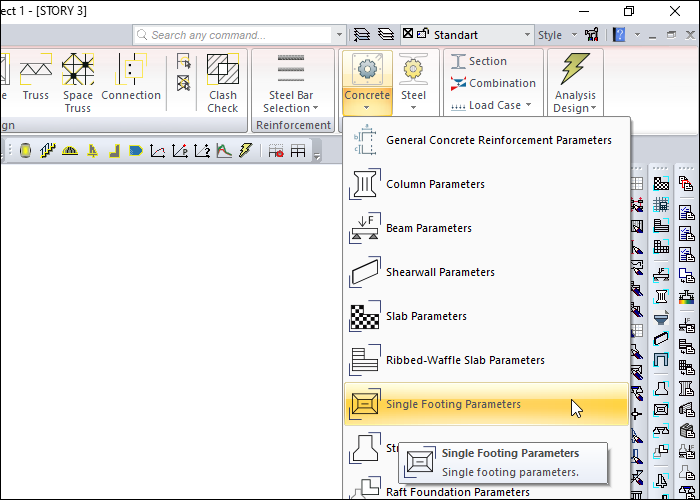

Location of Single Footing Parameters Dialog
Ribbon menu Analysis and Design tab Design Parameters title under Curtain parameters by clicking on the command Curtain Parameters can be found in the dialogue.

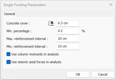

It determines with parameters which criteria the program will comply with in reinforced concrete design and reinforcement placement stage.
Parameters with the ( % ) sign mean the percentage expression of the rebar ratio. It is the ratio of the cross-sectional area of ​​the reinforced concrete element to the rebar area expressed as a percentage.
For example, when a “1” is written to the minimum percentage parameter, the rebar percentage is considered 1%. Since the percentage equivalent of a 0.01 rebar ratio is 1%, it is appropriate to write “1” to this parameter.
Concrete cover
It is the distance from the center of gravity of the rebar in the single footing to the outer face of the concrete.
Min. percentage
The rebar percentage determines the minimum value of the rebar to be placed in a single footing. The percentage value of the gross area of ​​the relevant section of the single footing specified in this parameter determines the minimum rebar area. The minimum rebar area of ​​the concrete element means that the gross section will not be less than the percentage value entered with this parameter.
Max. reinforcement percentage
In the program, the range of the rebar to be placed on a single footing is selected so that it is not more than the value specified in this parameter.
Min. reinforcement percentage
In the program, the range of the rebar to be placed on a single footing is selected so that it is not less than the value specified in this parameter.
Use column moments in analysis
The default state is checked. If it is not checked, only normal forces are taken into account in the foundation calculation from the effects of the column caused by vertical and earthquake loads from the superstructure. Column moments are not taken into account. In this case, the information on Mx and My values ​​is not displayed under the heading Column Loads Under Basement in the Single Footing report.
Use seismic axial forces in analysis
The default state is checked. If it is not checked, only vertical normal forces are taken into account in the foundation calculation, from the column effects caused by vertical and earthquake loads from the superstructure. Normal forces arising from earthquake loads are not taken into account.
