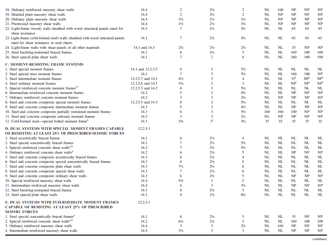

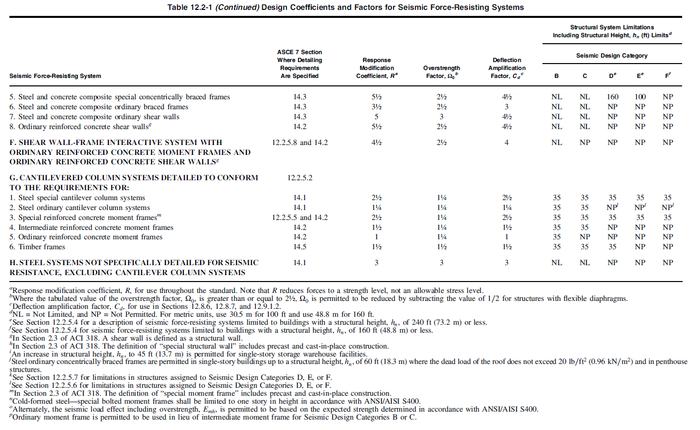

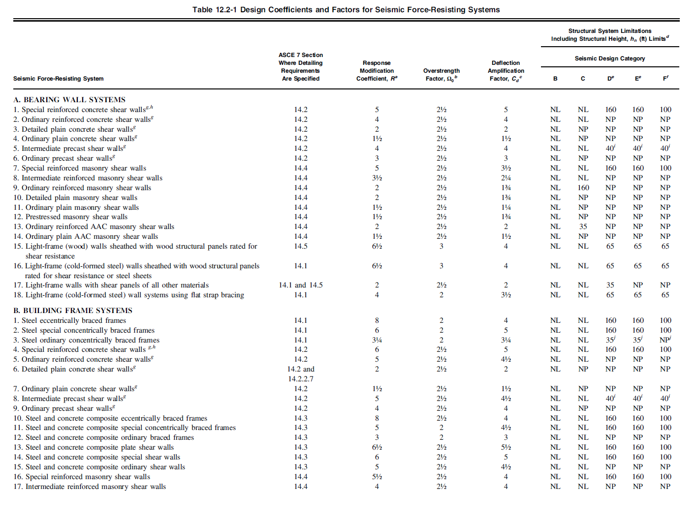

According to the ductility level you choose and the type of structural system in X direction, the appropriate structural system type is selected from the list. Table 12.2-1 includes structural height limitations.
In ASCE 7-16 Wizard, structural type and response modification coefficient and overstrength factor should be choosen for X and Y directions.
