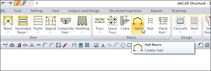

Hall Macro Command Location
You can access it under the Ribbon menu, Steel tab, Macro title.
  • Click on the hall icon.

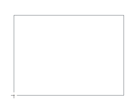

  • The outer frame of the hall will appear on the screen.
  • Select the point where you want to place the hole by clicking the left mouse button.

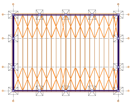

  • The hall settings dialog will open. Make the desired settings and click the OK button.
  • Your hall will be formed.
Determining the point where the hall will be placed
Formation of the hall
