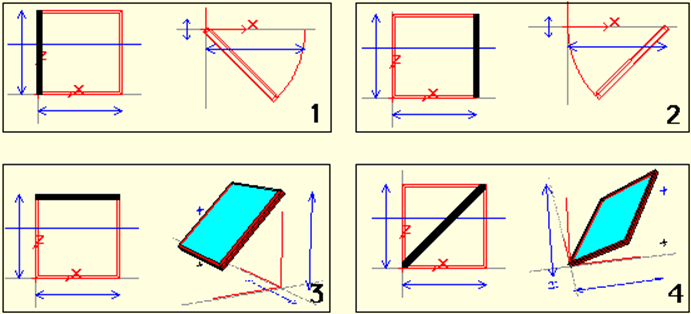

Below is an example of which 4 different rotation axes are determined on the same wing.
The thick black line represents the rotation axis.
