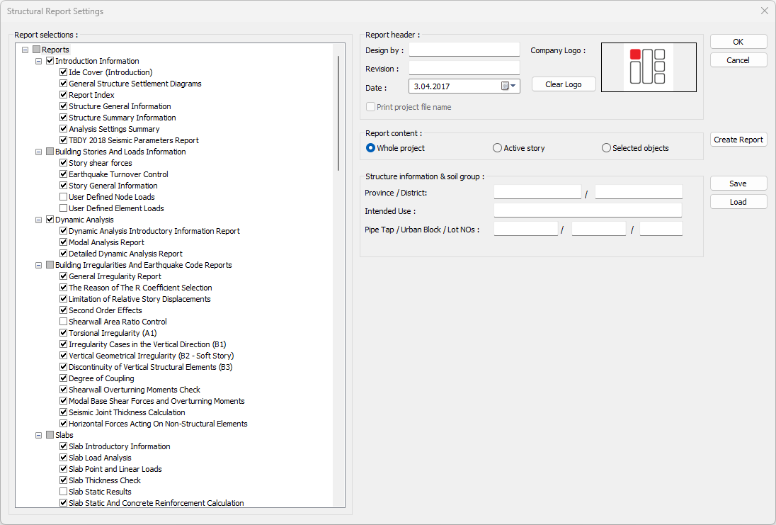

Selective reports allow the account printouts to be taken in one go, and also sets which report headers to be edited as account printouts.

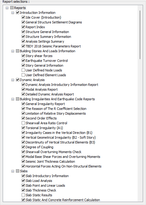

A list of all the reports that can be received in the program appears in the optional reports dialog. In the list, the titles that want to be printed out are marked, the titles that do not want to be taken are not marked. In addition, information about the project and the ground can be edited in the Optional Reports dialog and the company logo can be included in the report.

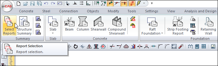

Location of Select Report Command
You can access it under the ribbon menu reports tab, Summary heading.

  • Click the Select Reports icon. The structural report settings dialog will open.
  • In the dialog that opens, you will see different options for the report.
  • After making the necessary edits, click the Create Report button.

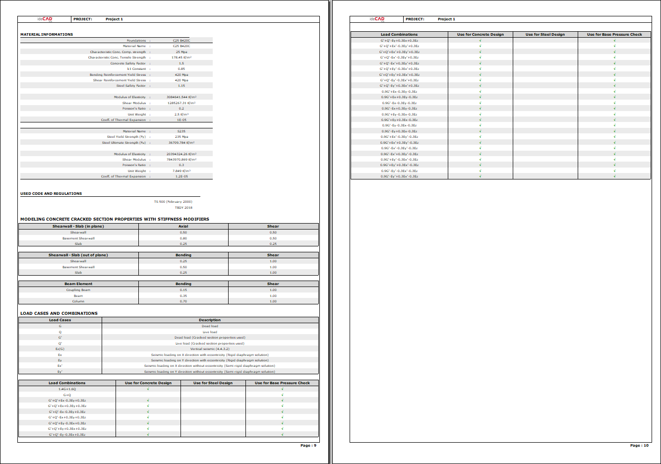

  • The ideCAD Report program will run automatically, your selections will be created under a specific page layout page by page under a single report.
Sample optional report pages
Structural Report Settings
Report selection
The reports that can be received are listed.
Design by
The designer's information is entered.
Revision
Revision information is entered.
Date
The report date is entered.
Company logo
The company logo is added, the existing logo is deleted.
Whole project
A report for the entire project is created.
Active story
The active floor report is created.
Selected objects
The selected objects report is created.
Province/District
The province/district information where the project will be done is entered.
Intended use
The intended use of the building is entered.
Pipe tap/Urban block/Lot NOs
The pipe tap, urban block and lot no information of the land where the building will be built is entered.
Create report
The report is created by clicking.
Save
Saves the report.
Load
Loads the previously saved report.
