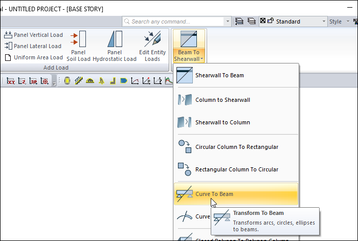

Location of the Curve to Beam Command

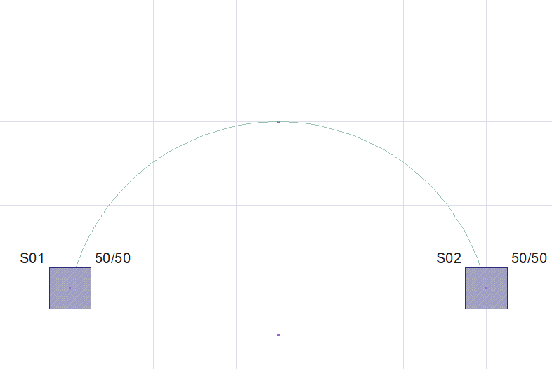

  • Draw an arc or circle.
  • Switch to structural design mode.
  • Click the curve to beam command.

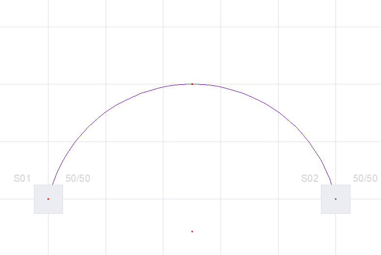

  • Select the arc or circle you have drawn.

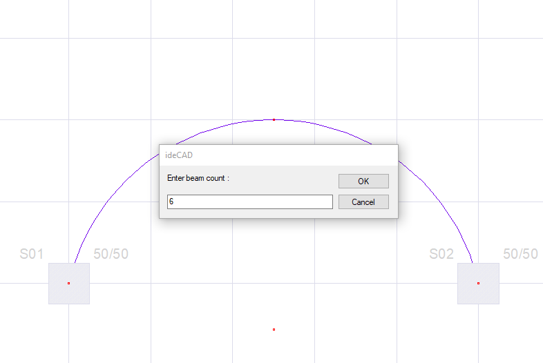

  • In the dialog that opens, enter the count of beams that will make up your arc. The program does not transform the arc or circle into a single beam. Places the count of beam segments you give here on the circle or arc. As the count of beams increases, the beam to be formed gets closer to the circle or circle. For example; If you transform a circle to a beam and give the count of walls 6, you will get a hexagonal beam, and if you convert the number of beams to 20, you will get a twenty-sided beam. The higher the number, the higher the curvature precision.

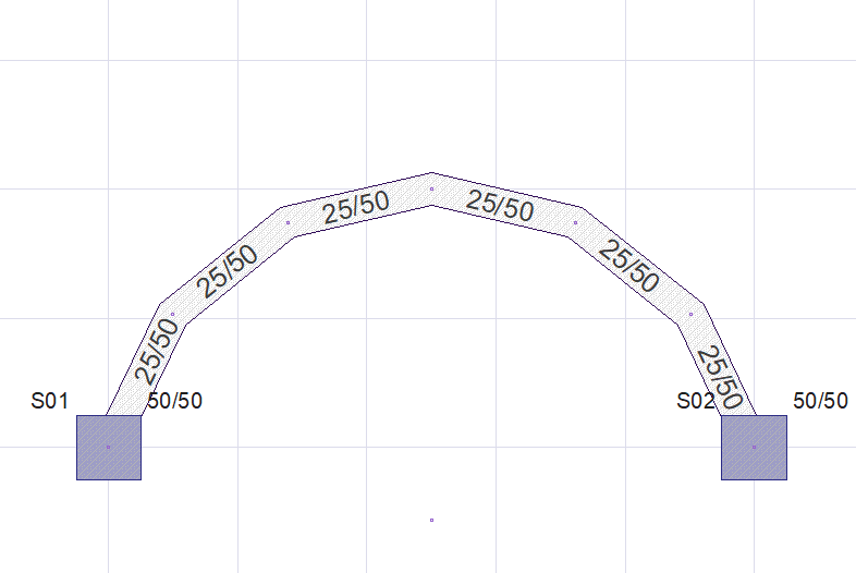

  • When you click the OK button, the arc or circle you selected will turn into a beam.

Arc creation
Selecting the arc to transform to beam
Determination of the beam count
Formation of the beams
