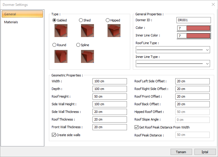

Dormer Settings
With the Dormer Settings command, settings such as dormer type, geometric properties and material selection are accessed.

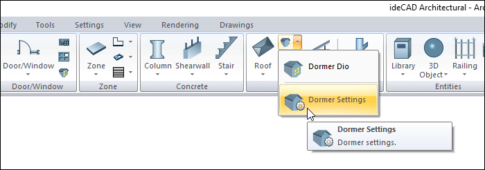

Location of Dormer Settings Command
You can access it under the heading of the ribbon menu, Home tab, Roof .
Gabled
It is an dormer type that has a slope in two directions.
Shed
It is an dormer type with a single direction.
Hipped
It is an dormer type that has three directions.
Round
It is an dormer type with a round shape.
Spline
It is an dormer type with a spline shape.
Dormer ID
Dormer is the name of the object that will appear in the plan and quantity.
It is the color of the eyelet object in the plan and in the 3D model if a texture is not assigned. You can click the color box and choose the color you want from the color palette.
Inner line color
It is the color of the inner line of the eyelet object in the plan. You can click the color box and choose the color you want from the color palette.
Roof line type
It is the line type of the outer contour line of the dormer object in the plan. You can select the desired line type from the list by clicking the line type box.
Inner line type
It is the line type of the inner line of the dormer object. You can select the desired line type from the list by clicking the line type box.
Width
It is the width of the dormer object. Width refers to the length of the dormer surface remaining parallel to the roof surface being worked on.
Depth
It is the depth of the dormer object. Depth refers to the length of the dormer surface perpendicular to the roof surface being studied.
Roof height
It is the height of the roof belonging to the dormer object.
Side wall height
It is the height of the lateral walls of the dormer object.
Side wall thickness
It is the thickness of the side walls of the dormer object.
Roof thickness
It is the thickness of the roof belonging to the dormer object.
Front wall thickness
It is the thickness of the front and back walls of the dormer object.
Create side walls
If checked, a wall is created around the dormer object and a roof over the walls. If not checked, only the dormer roof is created.
Roof left side offset
It is the left eave width of the roof belonging to the dormer.
Roof right side offset
It is the right eave width of the roof belonging to the dormer.
Roof front offset
It is the width of the front eaves of the roof belonging to the dormer.
Roof back offset
It is the rear eaves width of the roof belonging to the dormer.
Hipped surface offset
When hipped surface dormer types are selected, it is the width of the 3rd surface of that type.
Roof slope angle
When single surface dormer type is selected, it is the angle value that determines the slope of the surface of that type.
Get roof peak distance from width
If the option is checked, the top of the dormer roof is created in the middle of the dormer object. If the option is not checked, the position of the vertex is determined by taking into account the value entered in the lower line of the dialog.
Roof peak distance
If the get roof peak distance from width is not marked, this row becomes active. The location of the apex of the dormer roof is determined according to the value entered in this row.

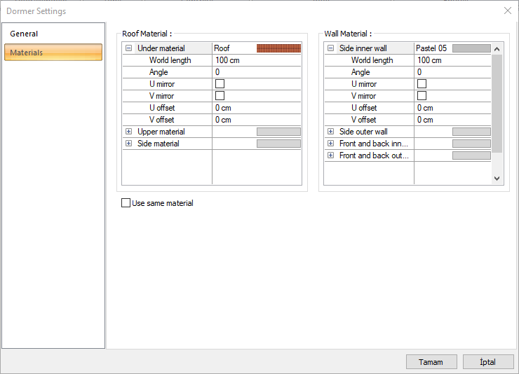

Materials Tab
Under material
The material to be used on the under surface of the dormer roof is selected from the list. The material list window opens with the left mouse button. The material is selected from the opened material list.
Upper material
The material to be used on the upper surface of the dormer roof is selected from the list. The material list window opens with the left mouse button. The material is selected from the opened material list.
Side material
The material to be used on the side surface of the dormer roof is selected from the list. The material list window opens with the left mouse button. The material is selected from the opened material list.
Side inner wall
The material to be used on the side surfaces of the dormer inner walls is selected from the list. The material list window opens with the left mouse button. The material is selected from the opened material list.
Side outer wall
The material to be used on the side surfaces of the dormer outer walls is selected from the list. The material list window opens with the left mouse button. The material is selected from the opened material list.
Front and back inner wall
The material to be used on the front and back surfaces of the dormer inner walls is selected from the list. The material list window opens with the left mouse button. The material is selected from the opened material list.
Front and back outer wall
The material to be used on the front and back surfaces of the dormer outer walls is selected from the list. The material list window opens with the left mouse button. The material is selected from the opened material list.
World length
Texture length is entered. For example; If 1 is entered, the selected material texture is taken as 1 meter and covered on the relevant walls. If the texture is considered to be in the form of a square, the object surfaces are covered by lining up 1x1 textures side by side. It can be determined separately for each surface.
Angle
The texture angle is entered.
U offset
The offset value of the texture in the x-plane is entered.
V offset
The offset value in the y-plane of the texture is entered
U mirror
It takes the symmetry of the texture with respect to the y plane.
V mirror
It takes the symmetry of the texture with respect to the x plane.
Use same material
If marked, the same material is used on all surfaces of the dormer. If not marked, materials defined for each surface are used.
