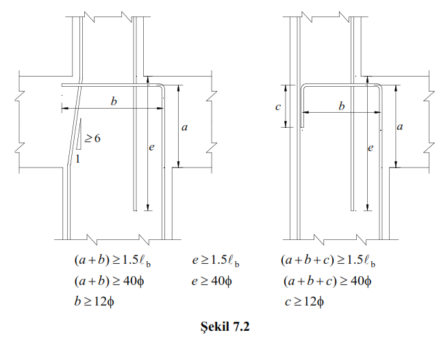

7.3.3.2 - In case the column cross section changes between floors, the slope of the longitudinal reinforcement within the column-beam junction area with respect to the vertical shall not be greater than 1/6. In case of greater cross section change or in the top floor columns; The clamping length of the longitudinal reinforcement of the lower column inside the beam on the opposite side shall not be taken shorter than 1.5lb and 40φ for the tension reinforcement given in TS 500. In cases where there is no beam on the opposite side, clamping will be provided by making a downward bend on the opposite side of the column if necessary. 90 degree horizontal hook or downward bent vertical hook height at least 12 φ will be ( Figure 7.2 ).
