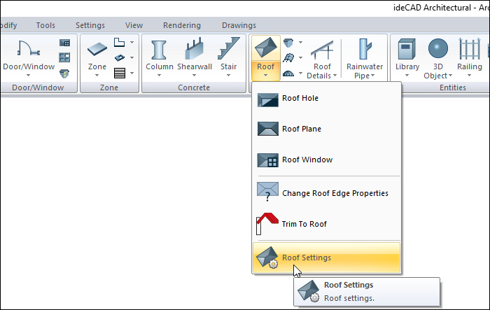

Location of the Roof Settings Dialog
It is available in the Roof helper toolbar that appears on the screen after running the roof command.
You can also access it under the ribbon menu Home tab Roof title in the architectural program.

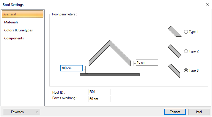

Roof elevation
The height of the roof from the floor is entered.
Roof thickness
The thickness of the roof cover is entered.
Roof eaves types
The preferred type of roof eaves shown in figures is selected by clicking with the left mouse button.
Roof ID
Enter a name for the roof object to be created.
Eaves overhang
Overhang length is entered. While drawing the roof, the eaveses of the polygon created are shifted outward by the value entered here to create a roof.

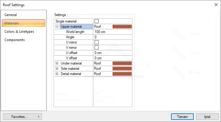

Materials Tab
Single material
 By selecting the single material option, the material selected in "Upper material" is used on all surfaces of the object.
Upper material
The material to be used on the top surface of the roof is selected from the list. The material list window opens with the left mouse button. The material is selected from the opened material list. The materials must be predefined.
Under material
The material to be used on the sub surface of the roof is selected from the list. The material list window opens with the left mouse button. The material is selected from the opened material list. The materials must be predefined.
Side material
The material to be used on the surfaces other than the top and sub surfaces of the roof is selected from the list. The material list window opens with the left mouse button. The material is selected from the opened material list. The materials must be predefined.
Detail material
The material to be used on the surfaces of the roof details is selected from the list. The material list window opens with the left mouse button. The material is selected from the opened material list. The materials must be predefined.
World length
Texture length is entered. For example; If 1 is entered, the selected material texture is taken as 1 meter and covered on the relevant roof. Considering that the texture is in the form of a square, the object surfaces are covered with 1x1 textures arranged side by side. It can be determined separately for each surface.
Angle
The texture angle is entered.
U mirror
It takes the symmetry of the texture with respect to the y-plane.
V mirror
It takes the symmetry of the texture with respect to the x-plane.
U offset
The motion value of the texture in the x-plane is entered.
V offset
The motion value in the y-plane of the texture is entered

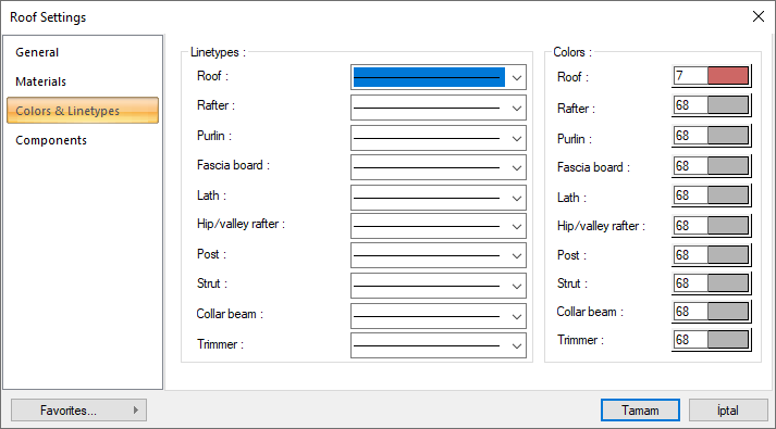

Colors and Linetypes Tab

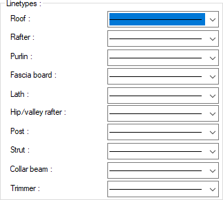

Linetypes
Linetype is selected separately for roof, rafters, purlins, fascia board, lath, hip/valley rafter, post strut, collar beam and trimmer. Clicking the down arrow button on the right side of the boxes opens the list of line types. From here, the desired line type can be selected by clicking the left mouse button. There are 22 types of line types available.
Colors
Different colors can be used for each roof element. Click on the color box with the left mouse button and the mouse cursor slides over the opened color palette. The button is released when the wanted color is reached. The color box turns into the selected color. If the color box is clicked on the keyboard with the Shift key, the pen thickness of the relevant color can be adjusted.

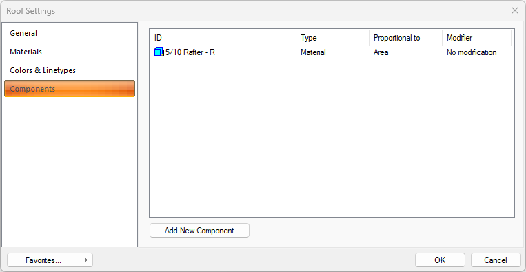

Components Tab

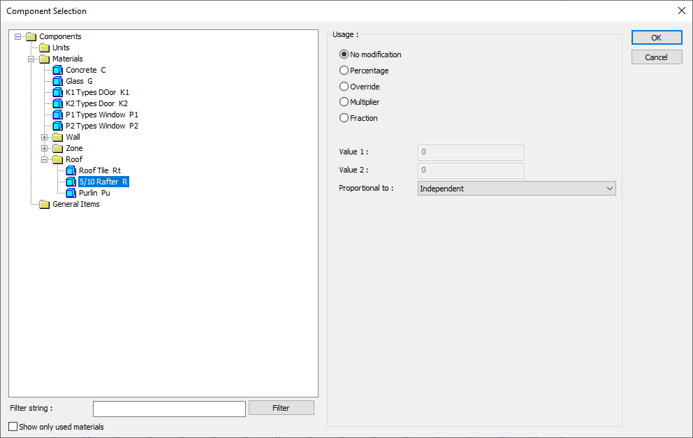

Add new components: Assigns the building materials defined for the detailed building components metering to the wall object.
  • Click the Add New Component button.
  • The Components Selection dialog will open.
  • In this dialog, click on the folder related to the material from the list on the left. Choose the material you want to use.
  • Click the OK button. The "Component Selection" dialog will be closed. A summary line of the material will appear in the Components tab. More than one material assignment can be made to an object.
In the usage section
Following are the lines that appear in the proportion list according to the roof object and material size.
Roof
Measure
Listed
Explanation
Constant
Independent
Length
Independent
Perimeter
It means that the length of the material will be found by multiplying the circumference of the roof with the length measurement found when defining the material.
Thickness
It means that the length of the material will be found by multiplying the length measurement found when defining the material and the thickness of the roof.
Area
Independent
Area
By multiplying the area measure found when defining the material with the area of ​​the roof, the area of ​​the material will be found.
Volume
Independent
Count
Independent
Count
Edge count
The number value found by multiplying the number of sides of the roof with the number of sides found when defining the material means to be used as the number of the material.
